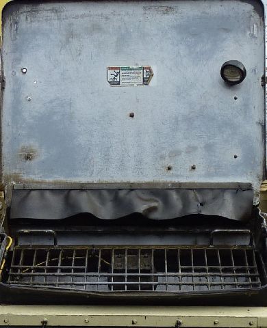

16 CELL | 08-11-2010 | reply profile send pm notify |
Try welding horizontal bars on the hopper grate (just make sure your vibrator is in good working order). After putting bars on ours I would estimate that plugging through 3" line has been reduced by about 80%, most of the dry balls you speak of will be broken up from the vibrating action of the double grate. It's probably one of the best low cost mods. we have done to our machines. |

Great pic 16 cell. I would prefer a removable add-on. The vibrator works great. |

stink21 | 08-11-2010 | reply profile send pm notify |
he said that he cut the pump off but it pressured out but does your vibrator work better turnedup sidedown like u have it |
pumpjockey | 08-11-2010 | reply profile send pm notify |
I have my vibe like that too. It keeps it out of harm's way. (mixer chutes) |

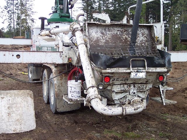

Deaner | 08-14-2010 | reply profile send pm notify |
i simply use a piece of 3" x 6" wire mesh cut to the size of my hopper. it keeps just about everything out that shouldn't be in there but can be easily removed if needed for a dry mix. my company owns a precast shop so thats where i got mine from but i'm sure that some of this stuff would be easy to track down. |
