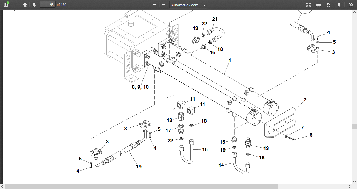

Putzmeister TK 40 trailer pump I might have a bad check valve. The cylinder bangs hard on one side (driver side). I think on every 4th stroke. The line surges a lot when pumping. How should I go about checking the check valve? Is it the U-tube located at the end of the cylinder? |

Concrete7111 | 03-24-2020 | reply profile send pm notify |
There are four check valves in u shaped pipes on both ends of the cylinders the end of the u with the longer fitting is the check valve it has a spring and cone shaped valve . I thought that might of been causing my problems with the cylinders going out of sync but no such luck . |
