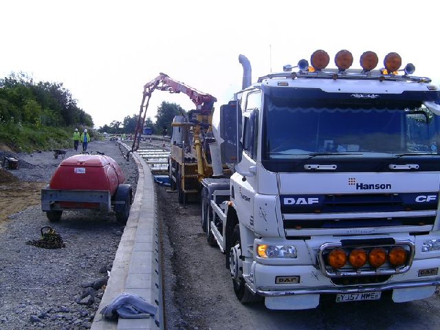

one clean mixer |

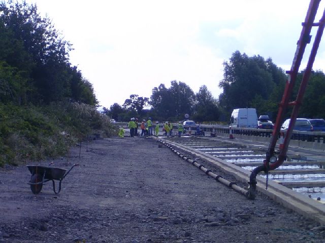

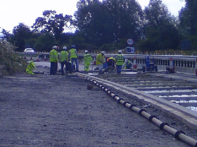

what gives ?? boom hooked straight to pipe. at least thats how it appears. come on man you cant do that.. a stubby works great. |

Glad to see you working. But one question, Why would they pump that? They can get right to it with the truck.Just curious. |

in the picture you can see hanger's in the bay for the expansion joint's to be mount'd on so no goin up the bay. And as for the side of the bay you cant get there because of the drainage further up the job. As reguard's the rubber you right i only put 1 load in then i could get a rubber put in from the other end. Not enough gear to start the job. |

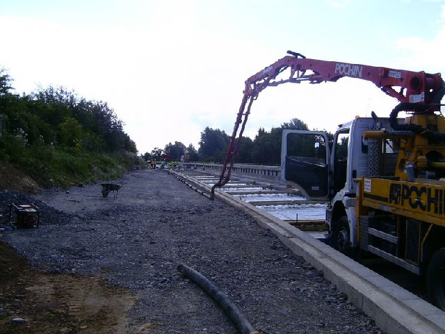

wow what size boom is that then you can unfold and swing to the side a little with your outriggers just straight down and not out at all ? |

it's a putz 16m the legs just go straight down |

ok thanks looks like a great set up for tight spots

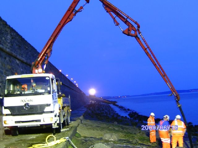

the jobs still on goin... back there soon after moving back 90ft...... here's a picture of how good theses pumps are |
