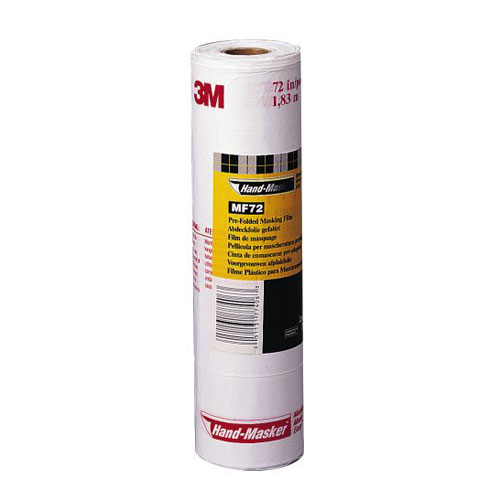

Trey | 12-08-2014 | reply profile send pm notify |
I use painters plastic, it works great and it wont fly 10 miles like those videos on youtube. It kinda acts like a paracute. |
