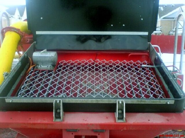

Hot water tends to loosen up the fin-fish too. But it's usually worst at the start of the season.
I also notice an increase in the amount and size of the cement balls from dry-batch plants during hot water season. But that always seemed to be worse in certain trucks, perhaps the condition of the fins is also a factor in that. |

To get rid of fin fish I use a fin fish net and it works great never have to worry unless you get a load of old hot mud that the vibrator cant break up and the mixer driver is to stupid to notice |
