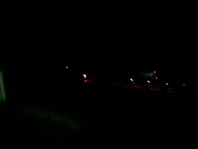

Pumping a small set of walls in Lamoine. Had to reach over the house, but a computer problem with the truck caused my remote to quit working. A couple phone calls and Gary and Duane had to come down and help me. We had run the pump and boom... manually with Duane guiding me over the house - in the dark. This is my view of Duane from the manual controls at the top of the turret. What challenge! ! I was very nervous. But we got the job done. Thanks Duane and Gary Moore!!See More

No fun! i finished in the dark 5 times this winter and it is treturous. I usually will not start if i'm not able to at least pump out in the light then clean out at dark. One new experience i had was walking back from around the hole after finishing a couple sono tubes in the dark, and a i fell into a four foot hole... Dah yah, it was so dark i couldn't see my own hand. No one even saw it happen lucky i fell on my butt and didn't get hurt. Its very unsafe. Usually because the mud is late. Plus it gets dark here at 4:30.

LOL great times Hippie.  Wish all booms manual valve were at the turret.
