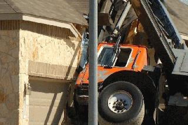

A truck-mounted concrete pump damaged a house when the rig tipped over Wednesday morning while laying a foundation next door.
Nobody was home when the truck's telescoping arm landed on the front roof of the house in the 11000 block of Schinz Field in the Laurel Canyon subdivision on the far Northwest Side.
Police officer Jared Herrera said the vehicle's operator suffered leg and ankle injuries that required hospitalization but none of the construction workers on the scene were injured.
One of the workers said the operator had just finished pouring its load of wet concrete into the foundation form and was beginning to swing the telescoping arm away when the accident occurred.
Fire Department spokeswoman Melissa Sparks said the house sustained $50,000 in damage. The vehicle's long arm damaged the residence's front porch and the roof covering the garage and the front part of the home.
Shortly before noon, a large mobile crane arrived on the scene to right the tipped truck and haul it away.

It`s something no one wants to see when they pull up to their home - a crane laying on their roof. A heavy equipment operator lost control of a concrete pump truck on Schinz Field in northwest San Antonio this morning. As a result, police say the crane crashed through a neighboring home`s roof. The operator told police one of the legs broke on the truck, causing it to tip. The operator was taken to Christus Santa Rosa Westover Hills Hospital with a minor knee injury.

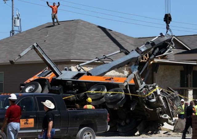

"D", maybe you need to be on this site for more than a few weeks before you can call people stupid. As far as this incident, I would guess that he had his front outrigger where the water and electric was ran underground for the house next door and not compacted. When he swung around, it sank. His boom was pretty much straight up, so it is not like he had a lot of weight over that side. Outrigger must have sank.

"The operator told police one of the legs broke on the truck, causing it to tip"
If what I just read is right, then equipment failure was the cause of this accident and not operator error. I have seen outriggers break while working before, its scary.

I also heard that the outrigger had broken and caused it to tip over.

I just noticed......The passenger rear outrigger is not even out. I am wondering if maybe he got distracted and started putting outriggers away before folding up.
smoothoperator.TX 09-13-2011
no the legs didnt break he finished the job sucked a sponge and forgot the boom was in the air still and pulled safety pins and lifted the legs. when u do this they be come free floating and they went banck in the truck cause it to land on the house it was a gentle fall too 100 percent operator error .this is a putzmeister concrete pump 32 meter they make good machines and was not any default on the machine this is what happen i know cause i was there and no it wasnt me that did it  that is me on the roof though
