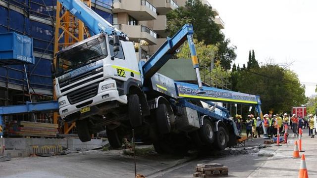

CRANES have righted a concrete truck that toppled onto a construction site in Sydney’s north. A childcare centre, units, part of a Westfield carpark and other buildings within a 75-metre radius of the Chatswood site were evacuated as a precaution during the operation. The truck was pumping concrete onto the roof of a four-storey construction site on Devonshire St when it toppled just before 9am, leaving its boom resting on the building. No one was injured and people were allowed back into their buildings after 1pm. Initial evacuations were extended to a 75-metre radius of the building site as a precaution.

Boomerr | 02-27-2014 | reply profile send pm notify |
Bad ground conditions Not enough dunnage? |

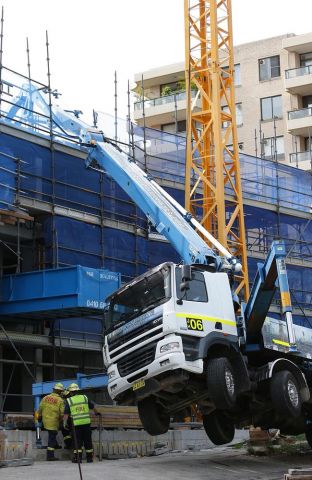

Mister_Perkins | 02-28-2014 | reply profile send pm notify |
maybe buddy tried to pick some system up while attached, and it tipped the pump up causing the rear rigger to fold in. -shrugs- .. Its a shame that happened :/ |

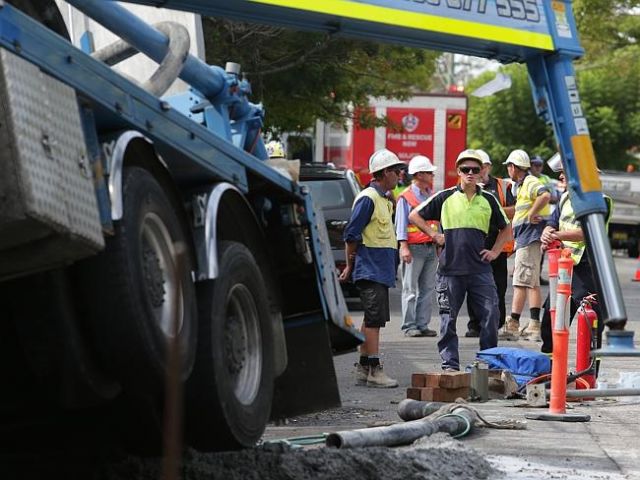

pumpslut | 03-04-2014 | reply profile send pm notify |
Apparently the back leg collapsed into an underground cavity that wasn't supposed to be there. |
Dipstick | 03-05-2014 | reply profile send pm notify |
Yea you can see that the right rear most be in the ground. Otherwize the rear of the truck would be hanging i the air.. |
