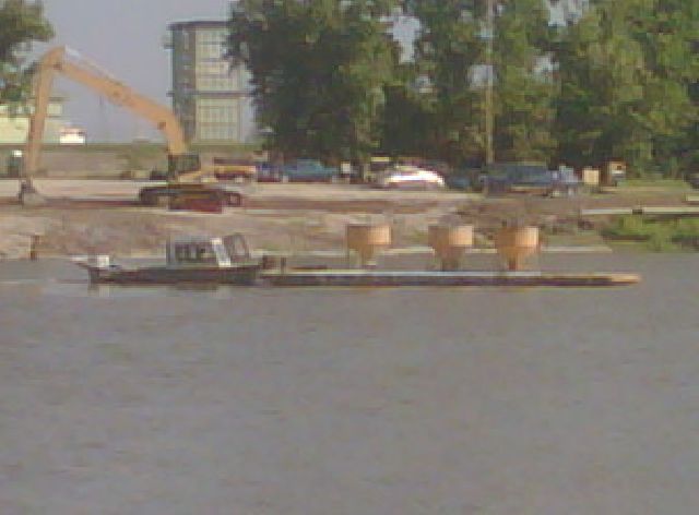

Can you please 'splain the situation? did the excavator in the back ground load the buckets on the barge? Is there a crane on another barge to place the concrete? How far out? Are there big barges around that could handle a pump and a couple mixers? Pictures are worth 1000 words, but without knowing the context of what's going on it's pretty pointless. Jus' sayin'. |
| "MUDDY" | 08-06-2010 | reply profile send pm notify |
there was a crane beside the excavator on land and one on the barge. we were pumping the void between the legs and the templates on a vapor recovery dock at marathon refinery. 3 buckets at a time. 650 yards total. over a period of 2 months. i had a line pump on the barge. more pics coming on same job coming now. |

Not good,bring a big lunch,no roach coaches out there. By the way,with all the water jobs you get into do you have web feet and gills? grin
everywhere you turn there's water here in louisiana. that was a 9 sack grout mix with 2% retarder at an 8" slump max. pumping 20 yards in 12 hour days with no cleanout between trucks. |

its a whole different game hookin up lines in a small boat. i don't know if you have ever delt with the mississippi, but that river is very swift. |
