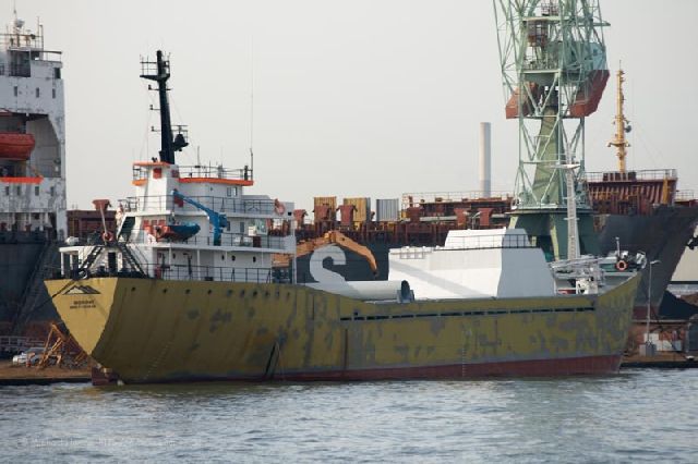

Anyone wanna pump offshore? |

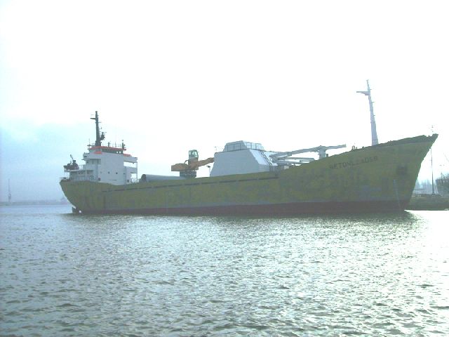

Is their a mobile concrete plant on that ship with a mixer also we cant see? |

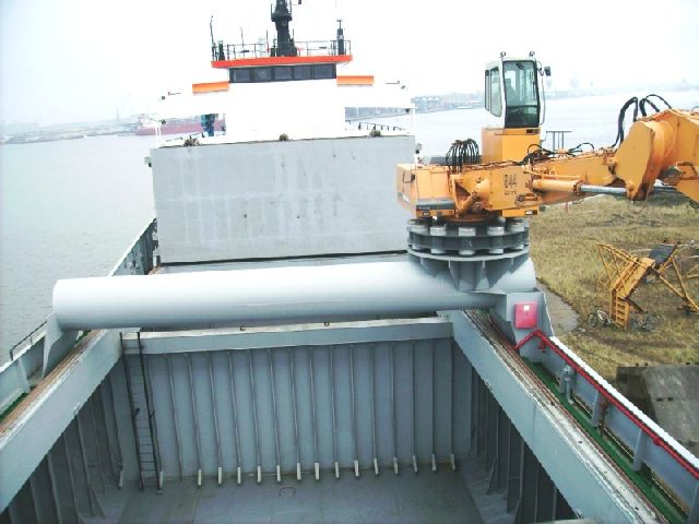

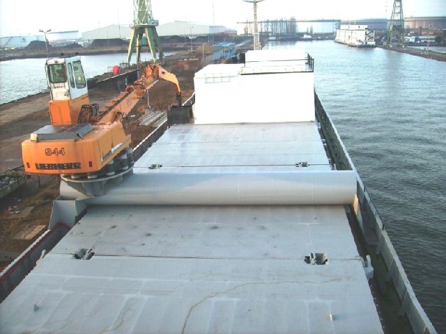

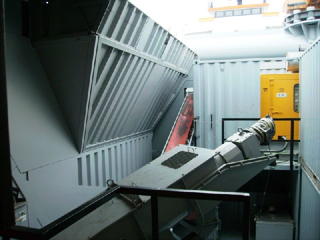

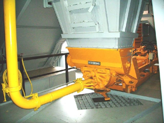

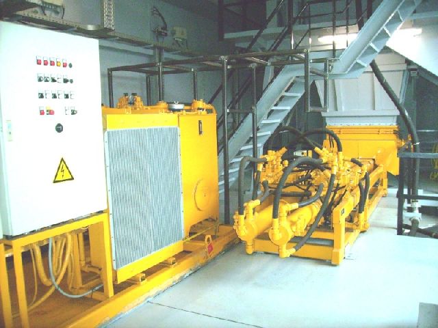

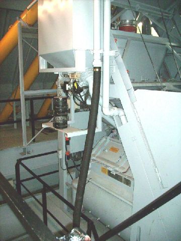

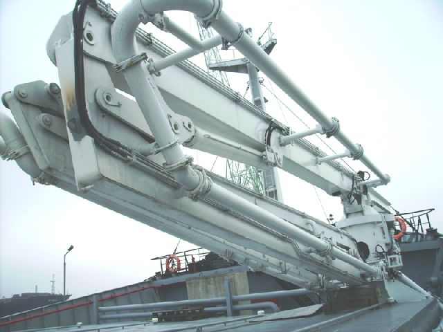

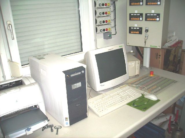

There is a Stetter concrete batching plant on board. Under the plant there is a Schwing pump connected to a placing boom on deck. Below the pump there's a recycling plant to take the concrete and water from washing out. On deck is a crane to take in sand and gravel. The ship can carry enough sand, gravel, cement, fresh water and additives for the production of 1000 m³ of concrete without being suplied by other ships. The name of the ship is Beton Leader and it's my father's ship. Some years ago we were pumping alot of under water concrete and we were working closely together with diving companies. For some jobs, my father had the idea of transforming a cargo vessel into a floating concrete plant. I helped him a litlle bit with the technical side of it.

how do you wash out the hopper with that batch plant right over it? does it raise? and i know this might sound silly but where do you get the water to batch concrete? does salt water affect concrete or do you remove salt somehow? |

To wash out the hopper you can open a hatch in the silo between the pump and the plant. |

I'm sorry Vasa. I wish I could say he needed a pump operator, a chef and a whole crew but he doesn't. The ship should be producing concrete in Dubai at this moment but due to the world wide financial crisis it's still lying in Antwerp. If you know someone who wants to buy the ship or who's got a job for it, please let me know. I think he will need a pump operator, a chef and a few other guys to operate the floating plant. |
