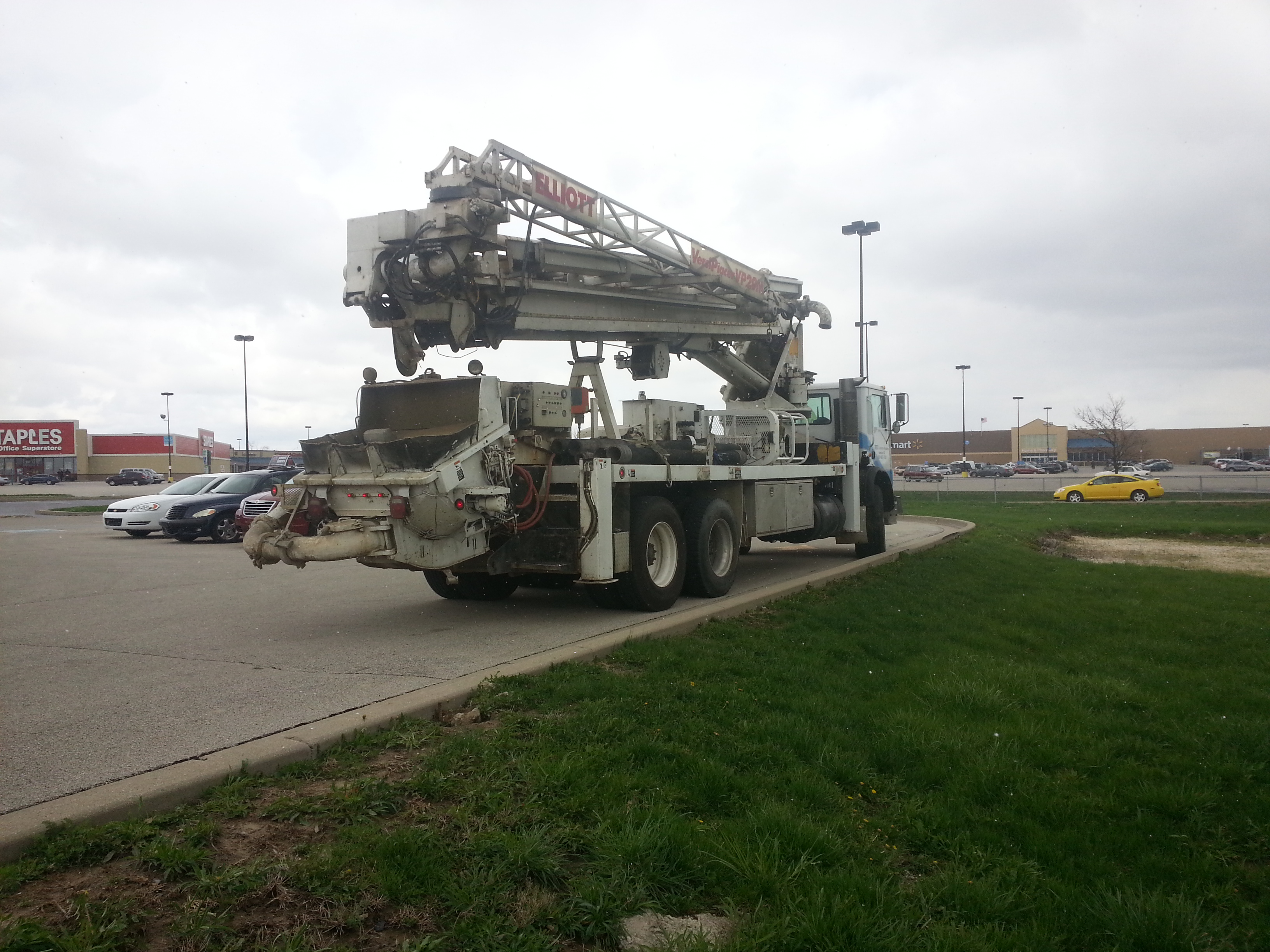

The Punisher 12-15-2015

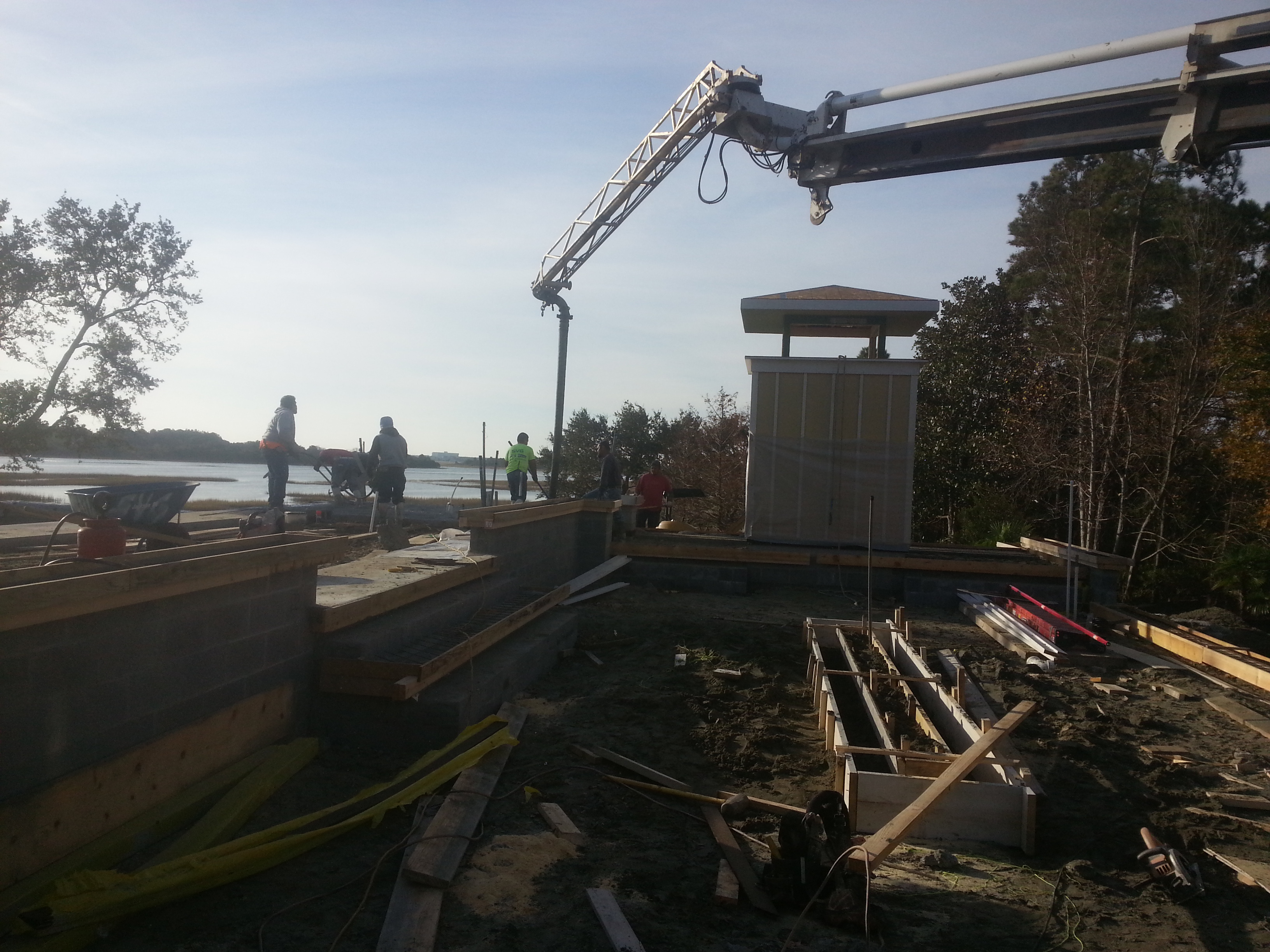

It is called a Versiplacer. Made by Elliot cranes who partnered with Putzmeister. 29M boom with a winch on the main to lift up 15000lbs. 360 degree articulating jib (it pumps around corners)  Jib has a winch on it rated at 500 lbs. The Jib also has a man basket attachment. Very fun to operate.

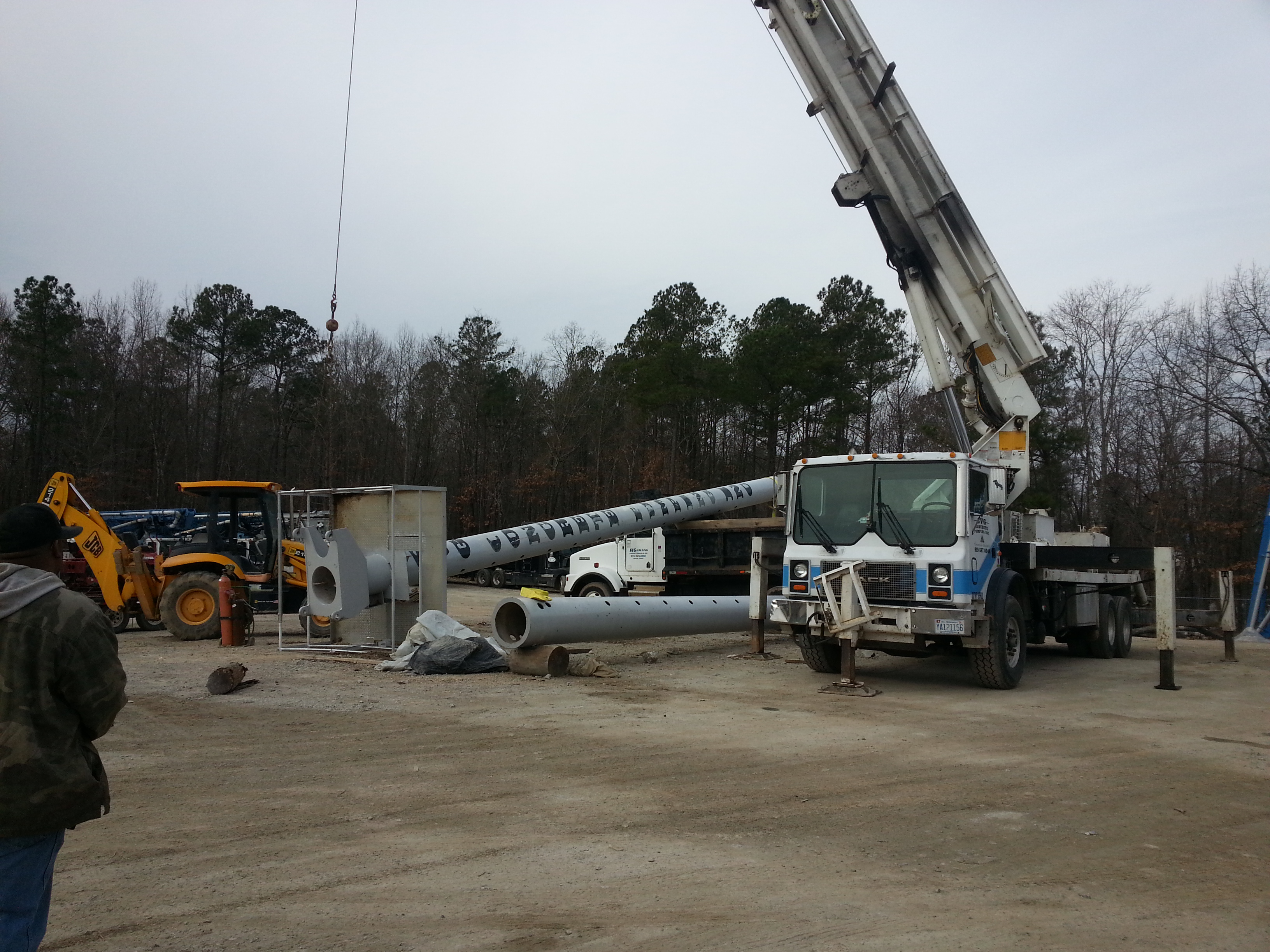

Here's a good hoist

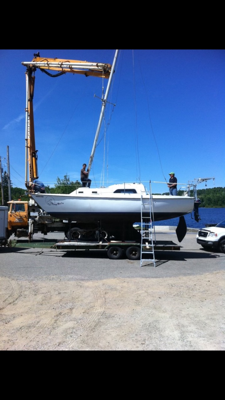

Some just don t care!!!my fellow competitor who do whaever it takes to get work!!

The Punisher 12-17-2015
I'm pretty sure 2004 was the last year they made them. The one in the picture I ran, I picked it up in South Dakota. It had quite a bit of rust from the road treatments. From what I understand they were pretty much a Midwest commodity

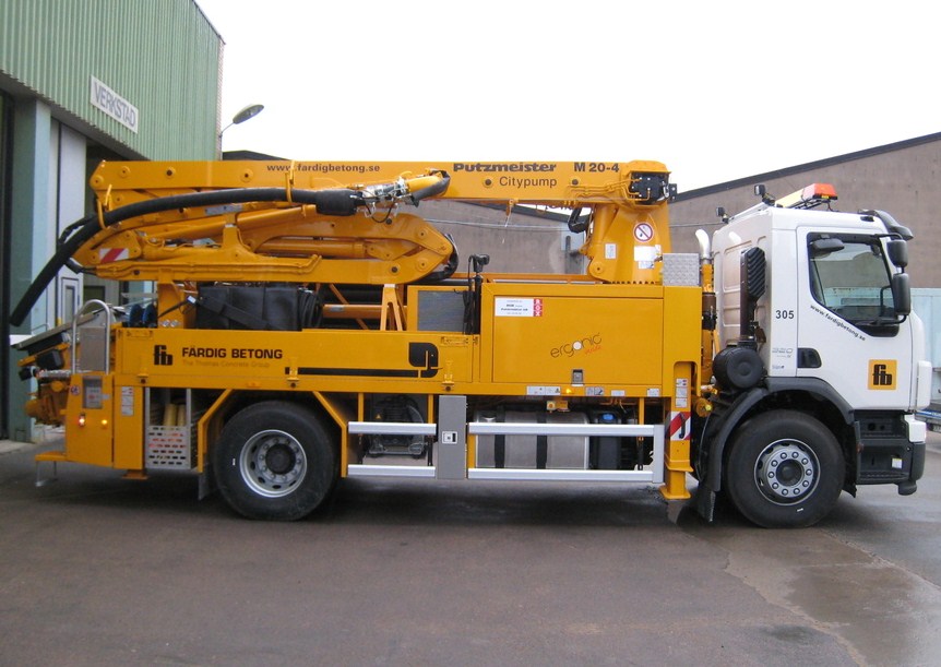

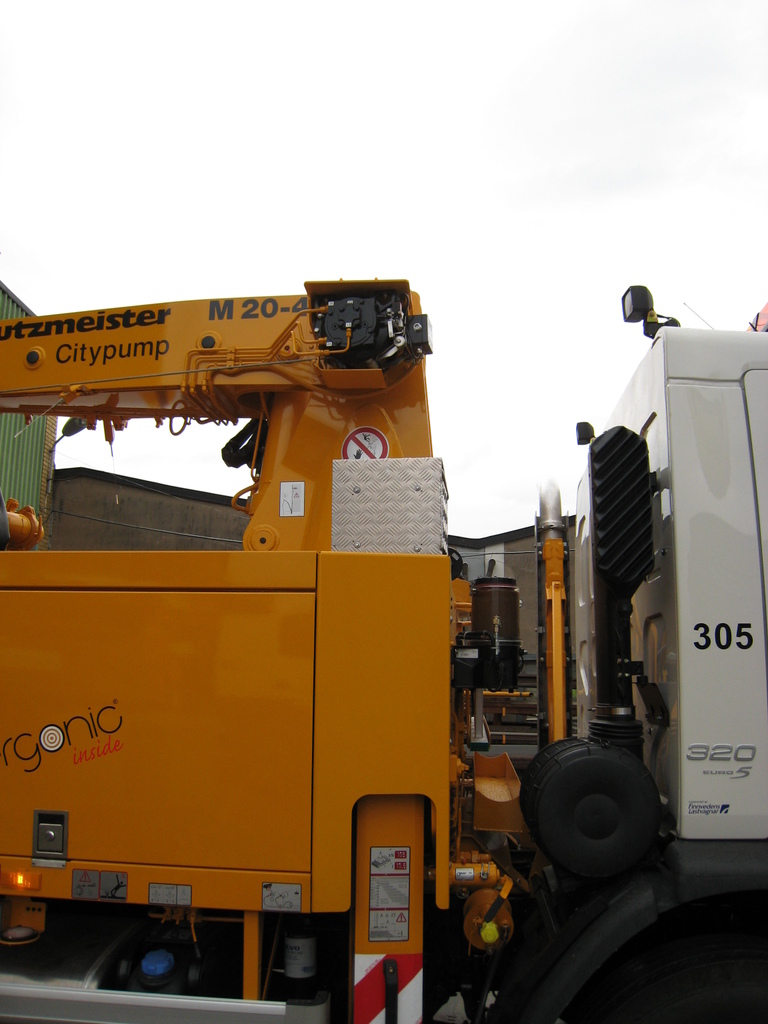

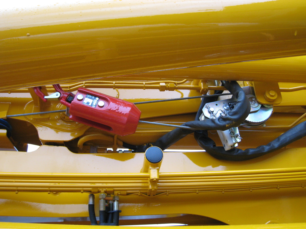

This little city pump is equipped with a hoist.
TooTall 12-24-2015
European model

Can anyone tell me more about this citypump with hoist machanism? Is that original putzmeister equipment or build by someone else? Can not find anything on their site )but must say Putzmeister has never been very impressive with its sites and giving complete information.)
GWR 12-27-2015
The only that is putz branded is pumpkit hopper boom piping. Its built on a Elliot crane boom an outrigger. Very versitle for low clearance unfolding height of 13'6"   but sub structure seems to be underbuilt for pumping abuse tho
greenguy 12-28-2015
The Putzmeister m20-4 with a hoisting hook is part of the "sanima" option, making the truck more line friendly.   The side rack is removable and the hoist hook is meant to lift the hose rack off the side of the truck and onto the ground For easier loading and unloading.   The reach appears minimal but I've never seen one in person.
see here:    http://www.pmw.de/pm_online/data/BP_3885_EN.pdf
