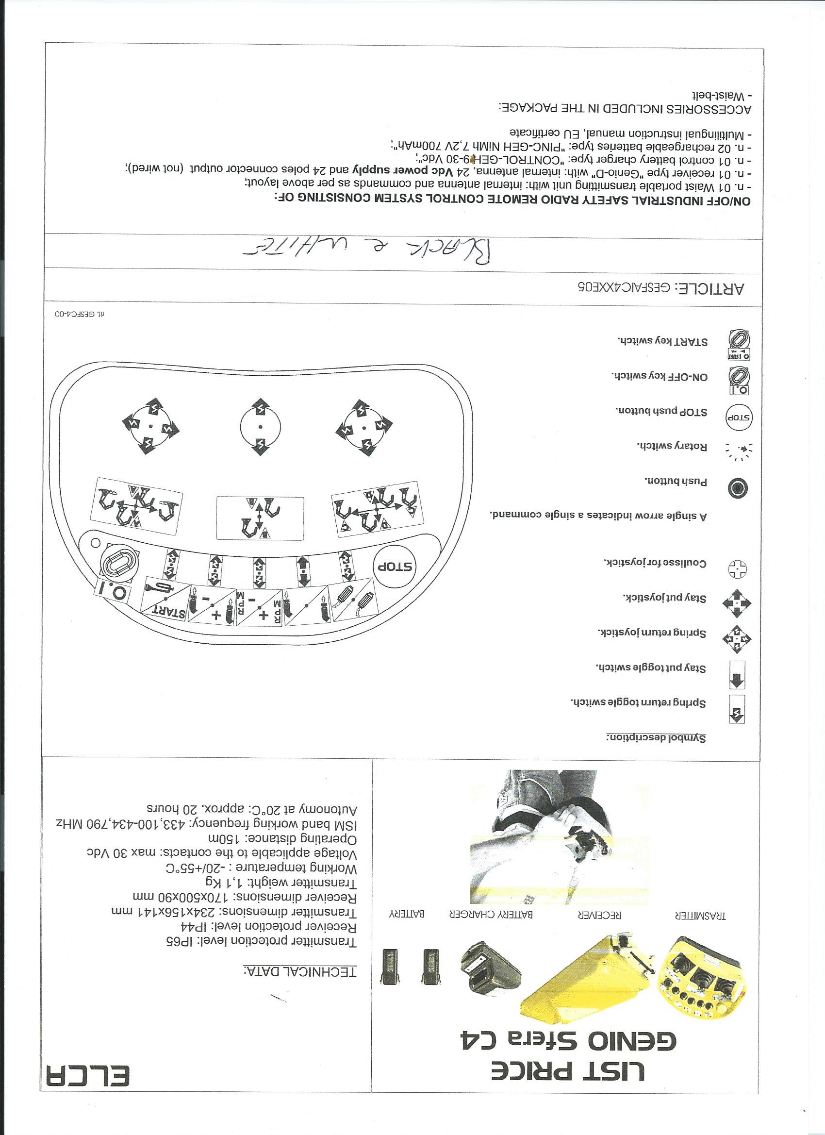

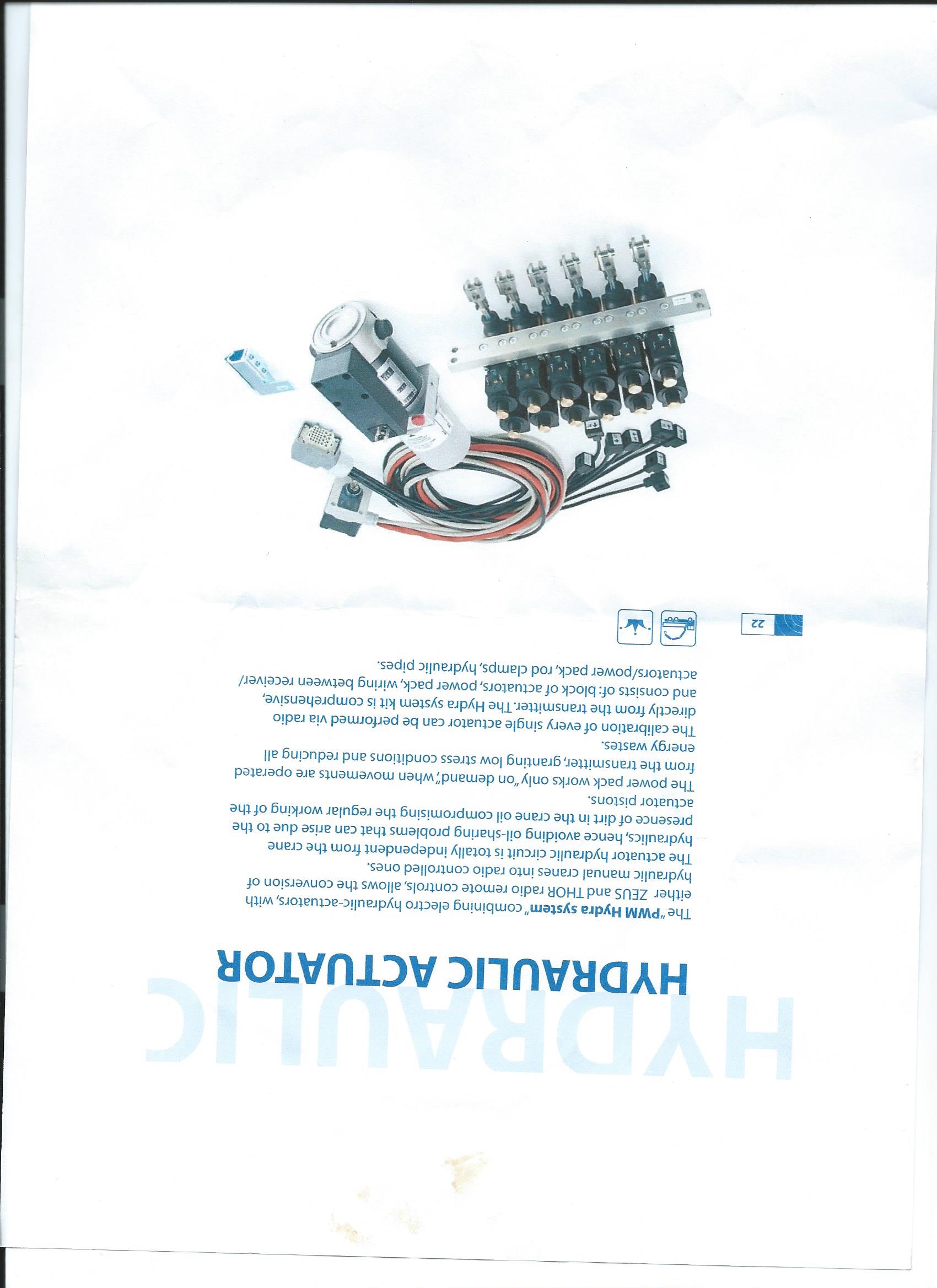

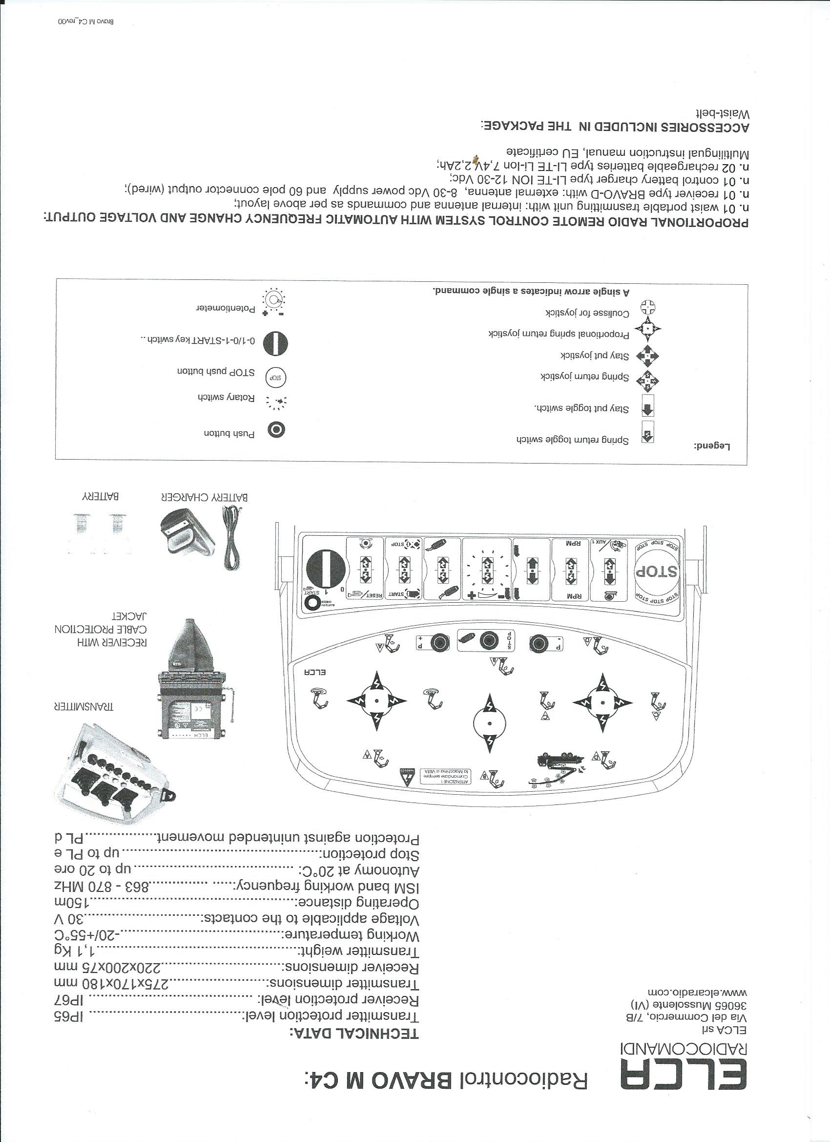

hi rookie, i am just going down the same path, brought a 26m x4 schwing from france, i am based in uk replaced all wear parts gland seals, piston heads all hydrauilic pipes behind hopper six brand new hannkock tyres new fuel tank, sun visor made up new racks , as mine is also black and white you can get what they call ahydrulic actuator, it bolts on to the manual levers,but converts to radio remote, from italy they are about £2,000 for the actuator and about £2,500 for reciver box and radio remote, plus a good sparky i have one |

on the pictures, there is a web site, should be able to get all info from that, there was some one in canada that got me a wireing digram from schwing germany, because schwing uk just drag there feet, i just typed in remote and lots came up the reason i am going that way, since i got pump could not get boom to lift on mauals, had some one i know whos very good on pumps, all the lights came on and he could get levers to move but just not on box , we think it could be one of the circirt boards, so have didcided to by pass and wire in a new reciver and radio remote, i think you would be able to wire the actuator, on your remote as it works off the levers, just ordered mine so hopefully have it up and running in a about six weeks , will send in some photos hope this helps |

hi gboom no , fundamentally its used on hydraulic systems that only use manual levers, so by putting on a hydraulic actuator it take away the clumsiness of using levers, when you can do it more smoothly, with a remote mainly used manual cranes, but all i am doing is by passing circuit boards and re wiring a new receiver and remote, so i will still have controls on back of pump for setting up and wash out ect, rather than spend loads of money trying to find out why, old remote wont work , its cheaper to buy a new one and get pump out to work, as its been sat in yard for three months |
