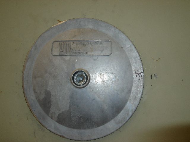

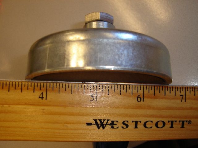

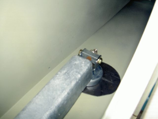

I will also add my two cents worth to the topic also.  First, we do need to make sure the anode is electrically connected to the tank.  But,we do not nee d to have a wire connected to the anode.  This is because of the special design of the magnetic mount that we use.  If you look at the two pictures below you can see the magnet is inset about 1/32-inch.  This will allow the outer housing, which is connected to the anode, to contact the metal surface of the outrigger leg.  Now, if the primer was not removed from the leg before putting down the magnet the anode would not work correctly.  So in the 50/60 meter machines we have a sticker that is placed in the bottom of the tank before the leg is primed.  They then peal off the sticker and put the magnet down on the unpainted metal surface.  For 30/40 meter machines they must clean off any area before putting the magnet down.
As far as marking the tank goes I have found out the following information.  On 30/40 meter machines the center inspection plate is stamped with an "IN".  This stamp could be on the cover or stamped into the tank itself.  On the 50/60 meter machines the stamping is on or next to every cover on the leg.  It seems that in current production 30/40 meter stamps the cover and 50/60 meter stamps the leg itself.  But in saying this, most of the time you will not see the stamp after the machines goes to paint.  As you can see in the 30 meter picture below, the stamp is almost completely filled in with paint.
I think we have a lot of good information for the customer to check: is the anode connected to tank using our magnetic mounts, is the anode in the bottom of the tank so it stays under the water level (water's electrical conductivity is the hole reason this thing works, and is also why it doesn't work in an open atmosphere - air is not a good conductor of electricity), and do we have the proper amount of anodes in the bottom of the tank?
In March of 2007 PM released an ECN to adopt zinc anodes for use in outrigger water tanks.  Tanks built after April 5, 2007 should have anodes.  Initially the covers were stamped to denote the presence of anodes, but this was replaced with a stamping on the tank wall, in the area of the cover, because the stamped covers sometime leaked.  If there is a question about the presence of the anode, it is best to remove the covers and visually inspect.  The inspection should be performed annually to check the condition of the anodes.
