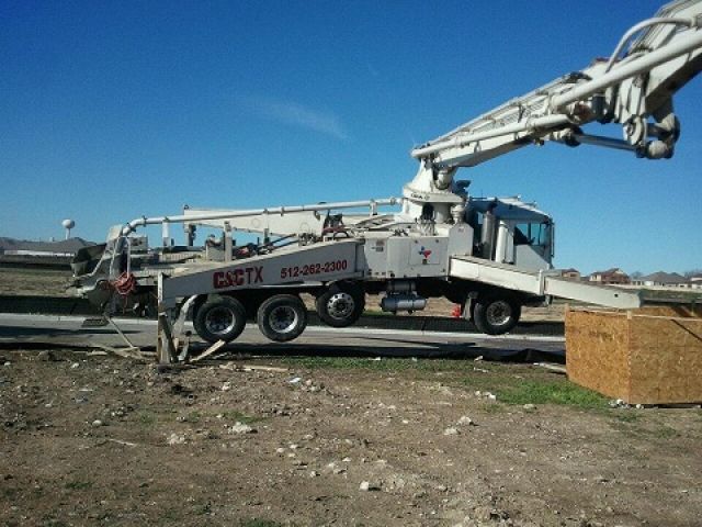

I had a couple of pics sent to me last week but not sure if I should post them. I will only post them if Todd is ok with it. Otherwise people will think I am bashing another company. But I see them as a learning tool. |

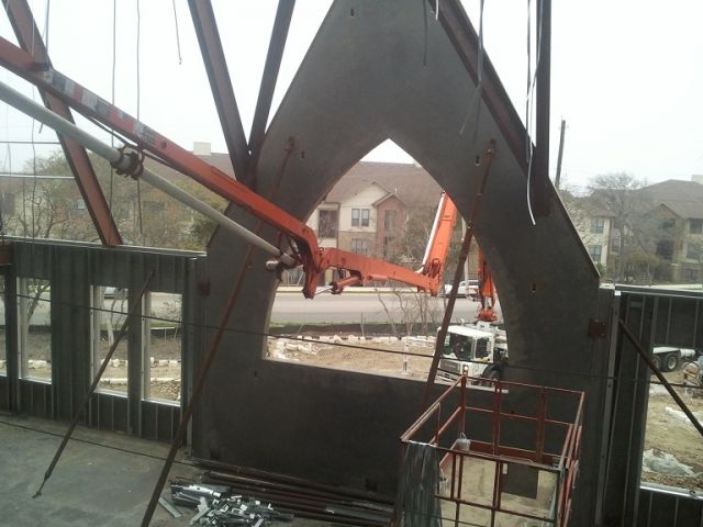

Here is another one from the same church. |

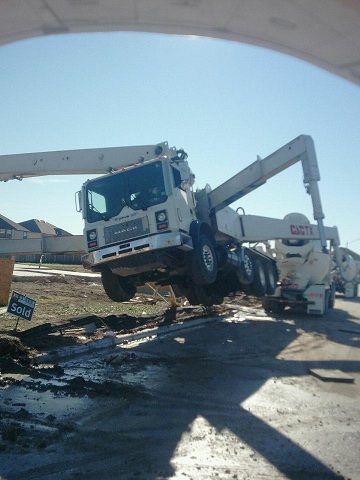

This is a good learning experiance for those that do not believe in proper cribbing. |

Goose2448 | 02-28-2012 | reply profile send pm notify |
I am no boom operator, but I think I would have set up completly in the street, and still cribbed. And nice work treading that boom through that little hole. |

biged | 02-28-2012 | reply profile send pm notify |
I bet its tricking getting that rig back on the ground. |
95schwing | 02-28-2012 | reply profile send pm notify |
It sure doesn't look like any riggers sunk. But it does look shorted on the back. |
Dipstick | 02-29-2012 | reply profile send pm notify |
I'd say the right rear sunk.. You can see all the broken wood stikking up. At least he gave it some efford but the wood was to weak and snapped.. But was it you Pink Panter? Your last comment makes it sound like that?? |
Beast | 02-29-2012 | reply profile send pm notify |
being ran one of those for a couple years I'm with dipstick I think it sunk enough to tip, lucky that rear outrigger didnt close more. |

Biged it's really not that bad that one looks easy, strap on rear outrigger with a crane or trackhoe and just put tension on it and boom up the pump and it will sit back down |
Wish I could see the front outrigger actually looks like it went down also |
