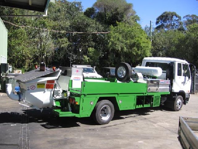

spraymaster with room left for the large air compressor |

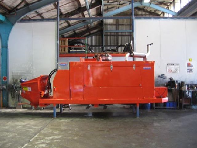

100 cyd Patriot with 250HP Caterpillar diesel ready for track mounting by customer. |

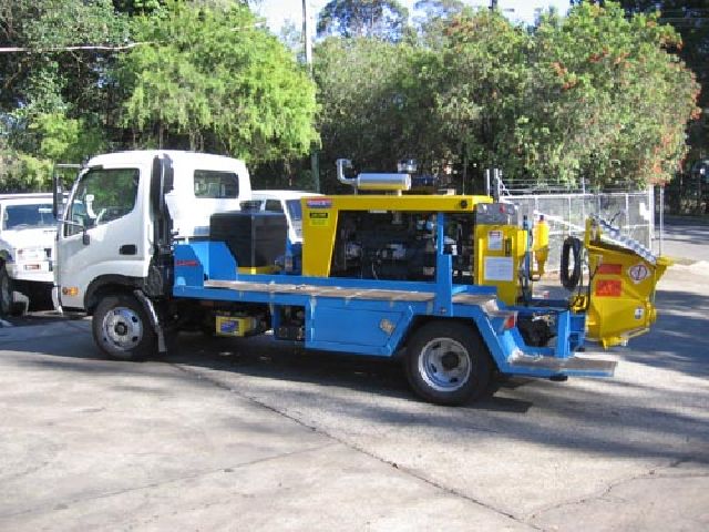

110 cyd Patriot line pump, 235 HP diesel "chip'd" to 270 HP with aftermarket chip, pump is 88 inch stroke x 7 inch bore, has 2,500 psi water blaster 130 gallon water tanks, 22 CFM hyd powered air compressor, 100 bar line pressure on piston side. |

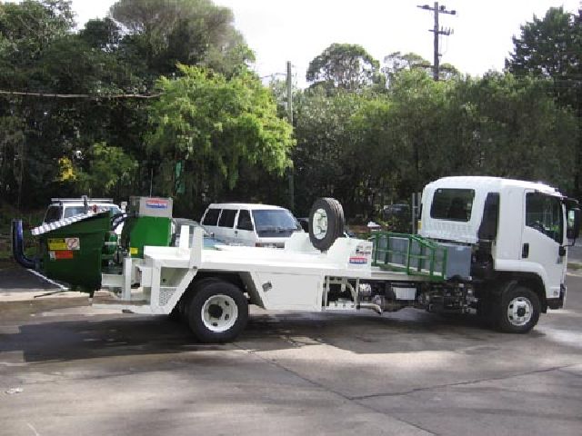

35 cyd Alpha on a 3 ton diesel, pump has it's own 70HP diesel, 2,500 psi water blaster, 16 CFM hyd air compressor, 50 gal water tank. |
