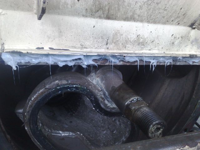

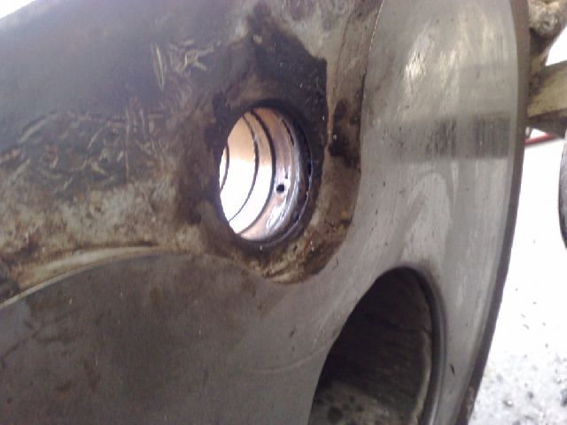

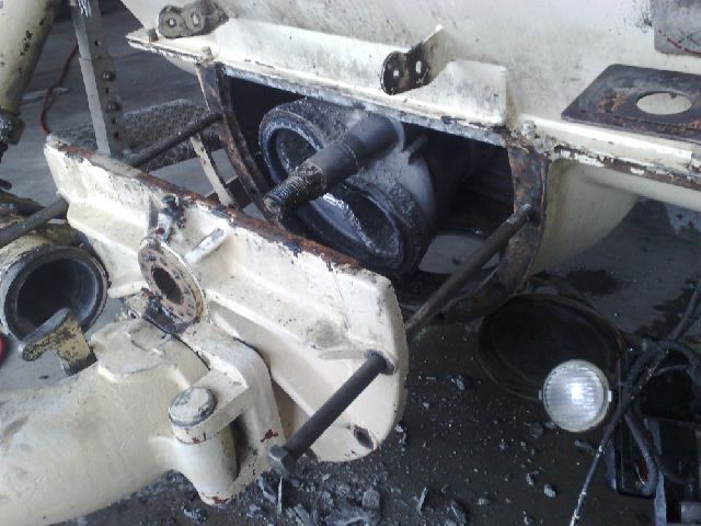

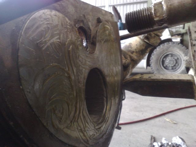

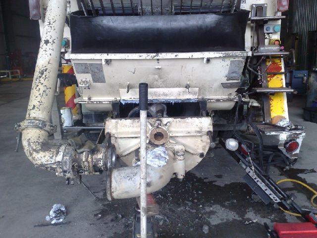

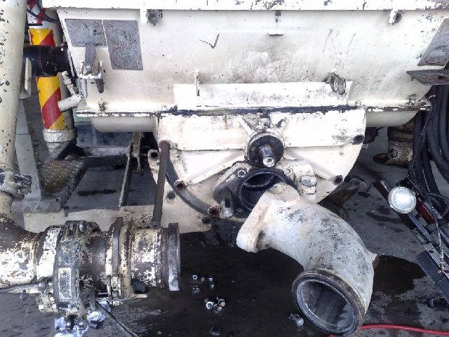

I'm pretty sure B-alto and pumpjockey had it covered in the description. Just thought i'd add a few photos. |
| b-alto | 12-03-2010 | reply profile send pm notify |
Sorry i didn't get back earlier i've been busy. But Nice photos Jonno.
Jonno is replacing the kidney seal also in that case you need the long bolts. I just did the cutting ring and pressure spring in that case you only need an inch of clearance. One thing to note is the importance of the rubber pressure spring make sure you clean the groove and replace it. Also the rear nut on the swing shaft don't remove it to do the cutting ring it will pull the rock valve back with the plate for you. Taking off the top hopper is easy and helpful. |
| Justapumper | 12-04-2010 | reply profile send pm notify |
Yeah b-alto mentioned the very important part don not take the rear bolt all the way out of the shift valve. Personally I like to replace the kidney seal with the new cutting ring and spring. The mudcups are more of a pain in trailer pumps to me than the boompumps. I have a piece of advice, take the cooling fan off. You may be tempted to try and do it from one side but dont, it will take twice as long. |
