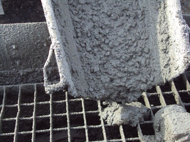

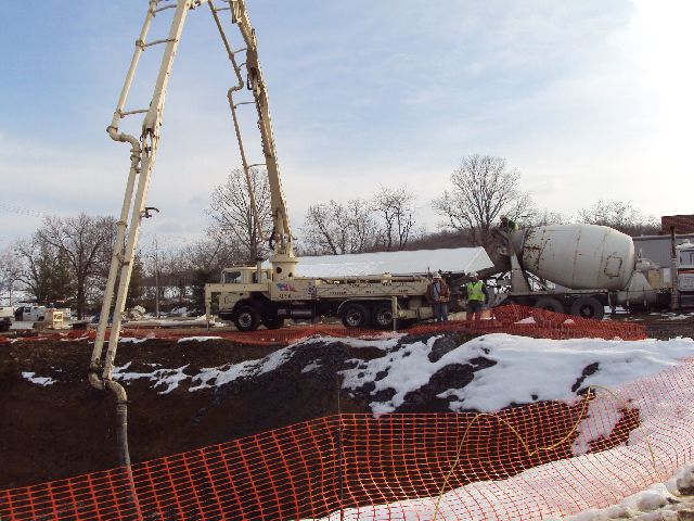

Headed to the job in New Market, Virginia. Was supposed to be a gravy job, 35 yds bull float finish on a sump basin at a waste water treatment plant. Got close to the job and called the Supt and told him to release the mud. Send It Back to Back!!!!. When we pulled on the job 1 load already there. Thought ok !!! get done sooner!!! Got the pump set up. No time too oil it down, figuring it would go quick enough it wouldnt set by washout time.Backed in the 1st truck, started to prime with water, plugged in the 1st section, reversed it 3 strokes, back forward, plugged in the 2nd section. Stopped the mixer driver from discharging into my hopper. Pulled him away from the pump. continued moving it back and forth till i got mud out the end. pulled all the mud out of the boom. The Rep with the Redi Mix Company was standing there the whole time. I ask him what kind of mix is this. 4500psi 100% Manufactured sand!!!! DAMN IT MAN!!! 3 loads on the job. The only way i could get the mix thru the boom was to suck air with it. Testing Lab telling me I'm running out of time on the trucks.. Takes me 2 hours to get 14 yards unloaded. Had to throw 2 loads away. Got the mix changed to blended sand 5000 psi. Waited an hour and a half on 3rd load.Kept the pump alive without washing out. mud got there pumped like butter!!! 7:30 on the Job Pulled off at 2:30 , 37yds |

Dude, they did crush it and it turned into SHARDS of rock!! The biggest thing with mfg'd sand is that the surface area of the sand particles is about 5 times what it is with natural sand, therefore, it needs more cementitious, not for the strength, but for the lubrication.
The water demand would be very high too, the pumping pressure would push water into nano-pores of the mfg sand, much like lightweight aggregate.
Flyash and cement, and a lot of luck is needed. blend sand is likley the best admix.
