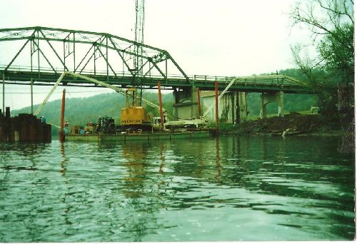

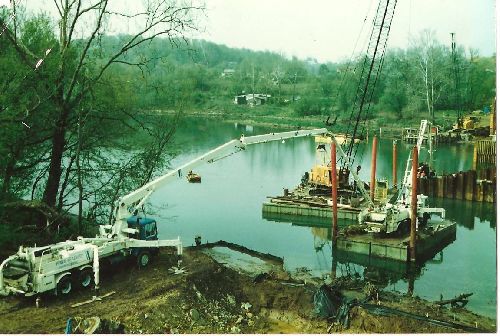

| PourItOut | 12-31-2008 | reply profile send pm notify |
