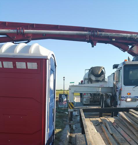

Does this happen often, I see it a lot.
Todd 04-23-2016
I am not saying this is good or bad just asking the question.
ATM14 04-25-2016
That's extremely unsafe. I would never recommend having an open space under a load like that. With how much weight is pressing down, if that outrigger pad gives...
PUMBO 04-26-2016
Looking at that photo the only 'real' issue that comes to mind is "if that boom comes down, you are almost certain the s**t will hit the fan".
ShortStik 04-26-2016
where i started pumping this the only place to put the outrigger on rezy jobs.  the dirt is a service line trench packed by city workers after side walk.  in the 39m,  if i set 2 feet back so the ashfault gets a square hole,  i'm 4 - 5 feet short from the back wall.  curbs are the best place to put the outriggers some places.
i would do a few things different, like not put the foot on the wall of the curb and still put a couple 4x6 on the curb so the whole pad has something other then air under.  to each his own...a shitty blow out
Dipstick 04-27-2016
If only he had a truck load of old wood materials available...
Thats the worst about most of these pictures. The material is right there but just to lazy to use it..
