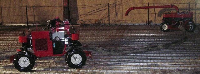

Tank | 03-05-2009 | reply profile send pm notify |
Here is a video of the line dragon on 3rd floor deck http://video.concretepumping.com/view_video.php?viewkey=7d3cd28dbbdd72be8f9a&page=1&viewtype=&category=mr Our best line pour we did 27,000 Sq in 4 1/2 Hr. sure bets dragging line my hand. |
