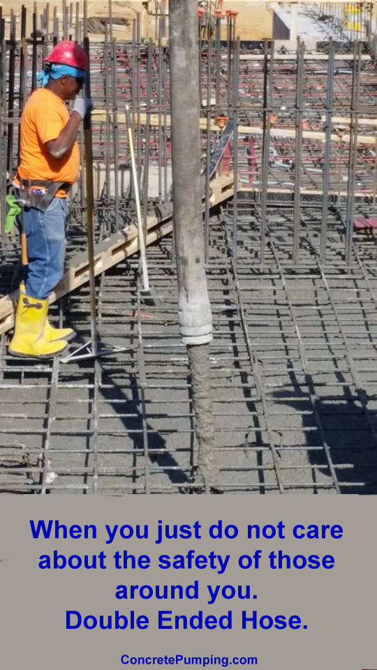

Please do not use double ended tip hose. |

Im not trying to get bashed by any means on this but why do you guys frown upon the use of double ended hoses im just curious thats all I know that on a release of pressure if plugged up they can whip around. |

That unnecessary metal end becomes a slingshotted 5 lb hunk of steel aiming for your head...better off to take the flogging from a rubber only hose...still hurts just not near as much potential to kill anyone standing within 10 feet. |
