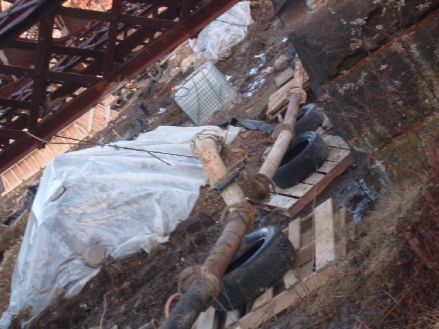

go up to wal-mart and pick up some of them big squishy foam balls. Soak them in oil for 24 hours, push the one plug inside of the pipe, install a 90 vertically up on your pump side, add one bucket of slurry. Push another ball in and add another bucket of slurry. Thats What we did on the Kinzua bridge job, and as far as priming and first truck everything went spectacular. Besides the fact that we ran a go-devil in behind the slurry / ball / oil mix, and we were at an 87% grade instead of 20. You could always go with bentonite (clay), but it will have a harder time sealing the clamp gaskets. When you go to clean up what are you going to do? Are you going to disconnect the 3 inch, clean it out and run a go-devil through the 4 inch? Best wishes

| Mister_Perkins | 11-19-2009 | reply profile send pm notify |
the camels hump pump jockey was talking about is what we used on the kinzua bridge job. Your only going down a 20-25% grade though, so I'm not sure if you'de need that kinda setup though. Really you should only need about a 1/2 yard of concrete to get the job done right. |
