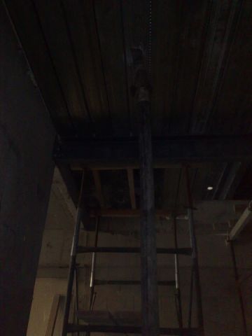

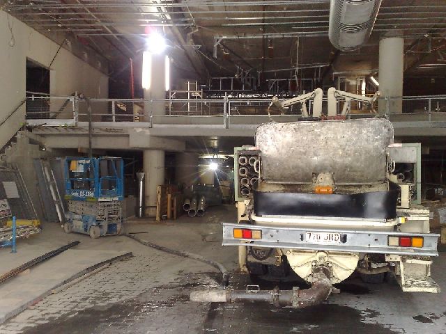

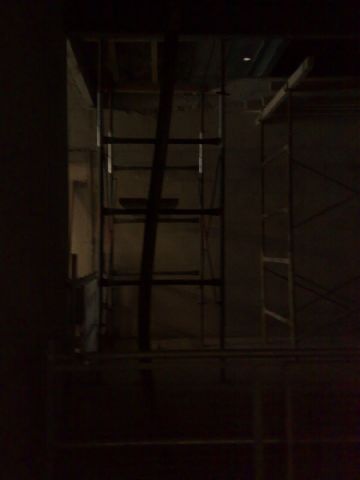

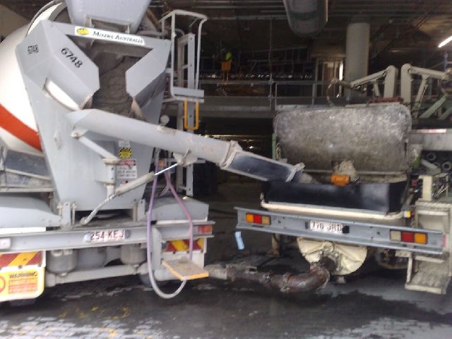

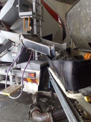

Wow.. So much line and the they come with this eppic sh't concrete?? Sorry for U mate.. How did it go? At least you did it on your own without ANY help from the factory ;-) |

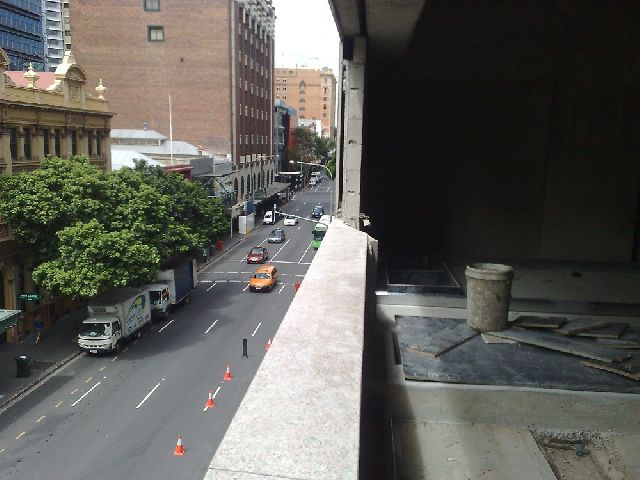

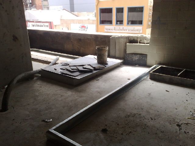

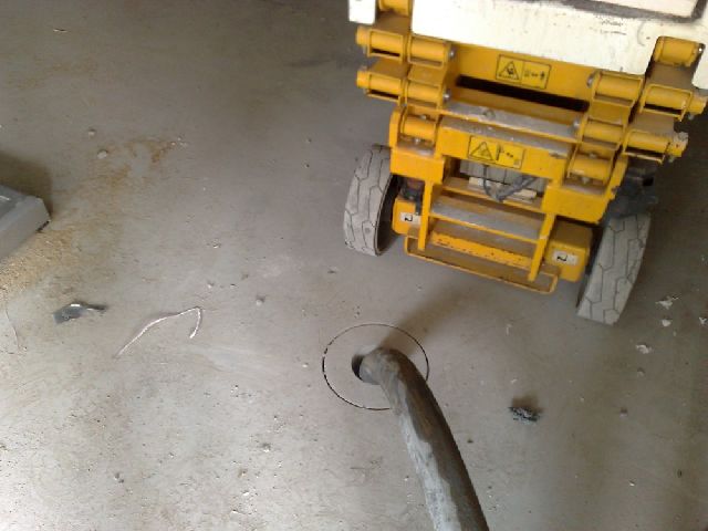

It line end up around 40m (130ft) of 2 ½, the concrete did get a little sh#t towards the end, it was over 2hours old, there were another 2 plinths that we did first that had to be barrowed because we could not run the line across the car park which is still in use. Sorry Dipstick I don’t quite understand what you mean” At least you did it on your own without ANY help from the factory” my company sent 3 men to this job, 1 operator + 2 line hands. After we had finish the plinths we had to drag the line back down to the pump and feed it through a penetration to the floor below and do some footings and a little slab;-) but it all went well thanks. |

Nice that you compagnie gives you so much help. We only go with 2 men when over 100meters line. I ment that the factory could have helped you a bit by sending some nice juicy crete. I thought the foto of your hopper was at the start of the job.. But ok.. after 2 hours it does tend to dry up a bit. I often experiance that I call the factory and tell them i need juice because i have a lot of line and then they come with such dry crap.. |
