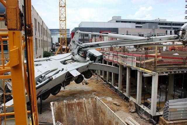

I don't get it. Every picture of a pump on its side, They are short rigged. When we going to learn, when someone dies? |

looks like pump owned by redi mix company named cemex. |
Mister_Perkins | 03-29-2013 | reply profile send pm notify |
Looks like the dude didnt have either rear outriggers out, or the other front pad, plus the damn front outrigger is planted on the edge of a concrete wall?! |

No excuse for that. Move that container or run some sections of groundline |

Dont see outrigger on wall its 8 feet inside building. Rear outriggers are short rigged. Does look like it says CEMEX on the side. In my opinion the name on the truck might tell you the whole story. Just my opinion. |

Oh your right that outrgger is on wall, sorry. |
