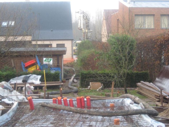

I think you're wrongly informed indeed. There are line pumps that give a lot more pressure then boom pumps. We're pumping at the moment a tunnel project i Brussels. With the boom pumps we go up to 200 meter of extra pipe at 80 bar of concrete pressure. With the line pumps we go up to 500 meter of pipeline at 115 bar. The same pumps have pumped a tunnel in France with 1,2 mile of pipeline. |

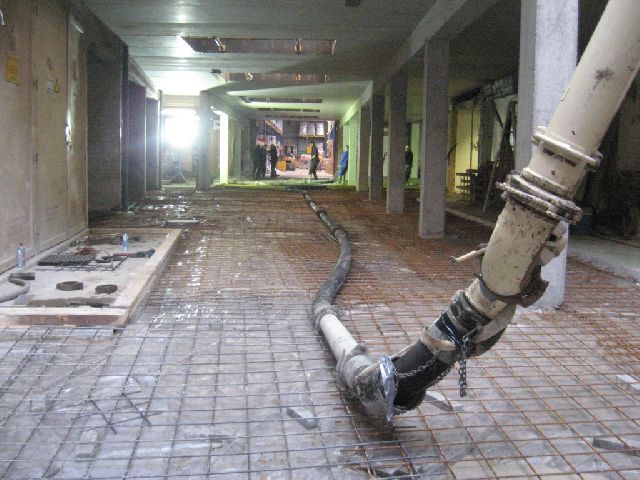

| Matthew | 04-03-2010 | reply profile send pm notify |

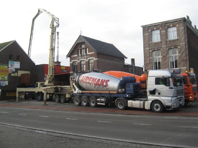

that looks like five inch hose in that last pic. can or have you run smaller dia. hose. just looked at my op. manual and it says 1" or bigger rock, can't use 3" dia. or smaller hose. you pumping bigger rock or just running bigger hose to not have packing problems. |
| Kris Leers | 04-03-2010 | reply profile send pm notify |

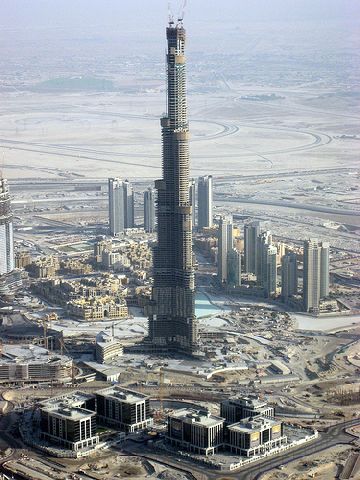

Some additional information: a Schwing boom pump has a maximum concrete pressure of 85 bar a SP 8800 243 bar. Putzmeister pumped at Burj Dubai up to 606 meter with a BSA 14000 SHP D operating at a maximum of 220 bar of concrete pressure. |
We usualy pump with pipes and hoses of DN 100 mm (4") and maximum agregate size of 32 mm or 22 mm depending on the suplier. We do use the 65 mm hoses (3") as well with maximum size aggregate of 14 mm but I don't like them. They're easy to handle but they get blocked up often as well. |

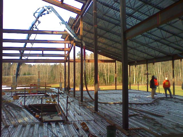

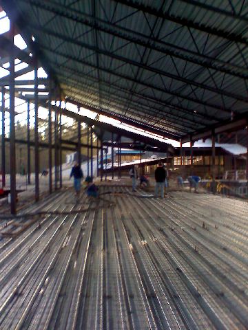

If you happen to run a pump without a volume adjustment, you can also put the PTO in a lower gear to reduce the working pressure. I have ran many trailor & truck mounted line pumps that deliver much higher face & working pressures than boom pumps. Also keep in mind that the material pressure at the end of the boom is considerably less than directly off the pump. Concrete is pumped through hose off the end of booms every day. It's not my favorite way to get it from point A to point B but I do it whenever I need to. |

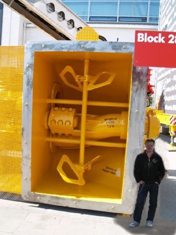

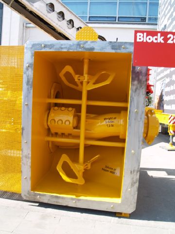

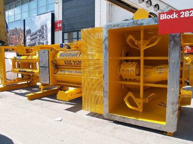

Kris, that is one hell of a module, no bending that swing tube shaft. you wouldn't have a pic of the change over rams would you? it looks like it is plumbed up rod side, strange for a high pressure machine and are those accumulators connected to the end of the hydraulic cylinders there to give each stroke some assistance on changeover? what was this one built for, i couldnt imagine 11inch cylinders, rod side doing dubia, but what would i know |

That big yellow pump module is probably for a mine tailings application, or sewage treatment plant bio-solids transfer. |
| Kris Leers | 04-05-2010 | reply profile send pm notify |
It's a picture I took from an industrial sludge pump on the Bauma 2007. The weight of the S-tube is 1,5 ton and the volume of the hopper 4600 liter. |
| 2IC | 04-05-2010 | reply profile send pm notify |
are you sure? it's big but it aint that big, 4.6 cubic metre hopper,??? |
| pumpjockey | 04-05-2010 | reply profile send pm notify |

Here's one with Kris in the picture. YEAH it's a BigBoy! |
It would sure suck to get amputated at the waist cleaning out the S-tube. |
Does it even have a clean-out door? Maybe they use a vac-truck. |
| pumpjockey | 04-06-2010 | reply profile send pm notify |
LOL, Crete, thaty's just TooTall with his Photoshoping skillz.... |
| crete | 04-06-2010 | reply profile send pm notify |
I'm such a moron!!! |
| 2IC | 04-06-2010 | reply profile send pm notify |
and i thought chris was 6feet 2, not 2foot 6 nice work tho |
| Kris Leers | 04-06-2010 | reply profile send pm notify |
Too Tall, it's not me, it's Dapper Dan next to the hopper and he needs a hard hat and safety glasses. |
