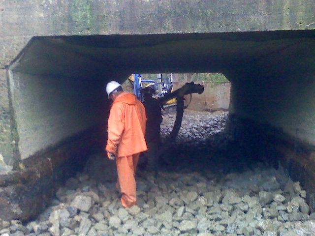

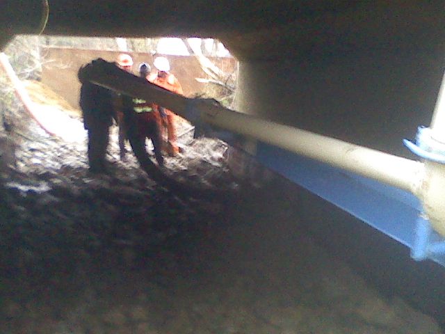

Reminds me of a line job I watched, probably the funniest day I ever experianced. I was in a mixer the operator was off the ground excited to be there making dbl time, all I rember was easy money buddy easy money hehe. He strung out 150ft of 2inch line off his line pump then said we had to wait for a fitting being custom made from his shop. I had high flow 200 slump on, no agg. So 2 hrs rolls by finally the fitting came, hahaha A 1.5inch screw in nosel. Hmmm under the hwy this thing goes they were srewing this fitting int the culvert and going to fill the voids, hehe so another half hr rolls by, then operator sarts the prime and is still grinning ear to ear about easy money, he stops the prime then 5 minutes the pump starts stroking hard. Hmm out comes a grey head to toe operator swearing like a nun in hades. I hate my job, I hate my stupid job, I still laugh today, your pictures bring back that day hehe I know not the same. |
