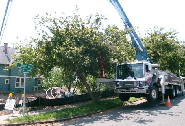

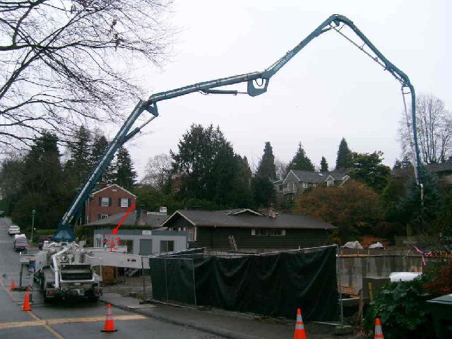

There should be no such thing as 'shortrigging' pumps with swing type outriggers, new and old. Especially with older models with outriggers like a Schwing 42m & 31m. You can get away with not extending them on the non working side but having them fully swung out is a must. If that rig that went over would've had its left front outrigger swung out but not extended it would have stayed put. Had it been a pump with X stye outriggers it would also still be standing, unless of course the foot wasn't planted on the ground. Most accidents I have heard of involving a shortrigged pump that tipped over was because the operator "Forgot" that he was short on one side and was asked to move the boom somewhere he wasn't expecting to. I've came close to doing it my self enough times that I've adopted a little 'reminder' system... I always have a stack of at least 3 road cones, not just for traffic but also for marking off power lines and other hazards. Whenever I have to shortrig I place a cone on top of the outrigger that I'm not supposed to boom past on the working side. It's a reminder Not to swing past that point and simply taking the time to put the cone there makes your brain more aware of the situation, like this.... |

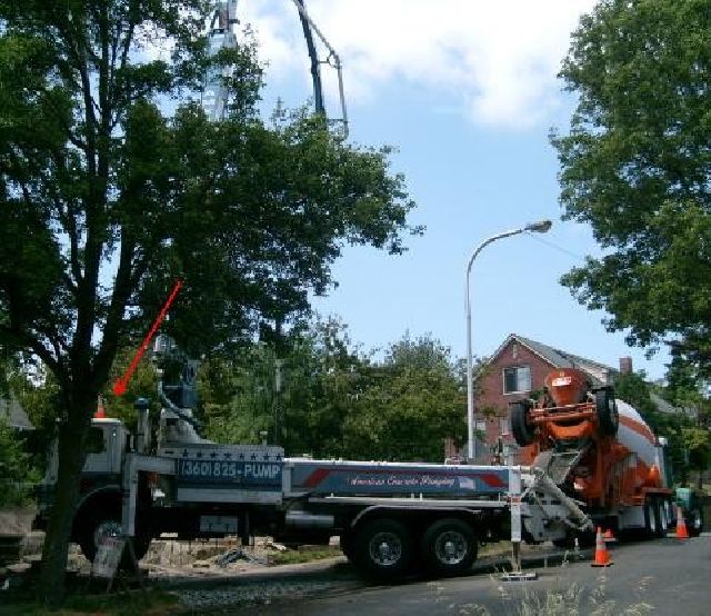

Sometimes I'll put it up on the cab like this one... |

thats somethin we all need to institute some kind of policy that reminds us where our safe zones are,as usual TT you do not disappoint |
bisley57 | 07-06-2009 | reply profile send pm notify |
TT,your cone thing is one of the best ideas I have heard in a long time.I don't even carry cones,and after 24 years of fooling with these contraptions I should know better.So I guess that means a little road trip to the local box store for some bright orange reminders........ |
TooTall | 07-06-2009 | reply profile send pm notify |
BBCP adopted their 3 cone policy for power line awareness over 10 years ago. I haven't worked for BB for several years but I've carried 3 road cones ever since. One late afternoon (evening) I had set up short with a thirty six and almost did the typical brain dead pump flop! They asked me to boom to the other side of the street to catch some sono tubes that they forgot the day before. The boom was nearly half way over the cab when I walked around the other side and realized/remembered the outriggers were short rigged. I've been tossin a cone on the outrigger or up on the cab ever since! It works great for me, We all get tired and out of routine once in a while and thats all it takes! Just the simple act of going through the motions makes one more aware even on a subconcious level. Weather its power lines, short outriggers or whatever we may need to be reminded and aware of seeing the cones is a visual reminder and taking the time to put them where they're needed makes us much more aware of what's going on! Maybe some day this will be an industry standard? "Know your Safe Zone, Mark it with a Cone" |
