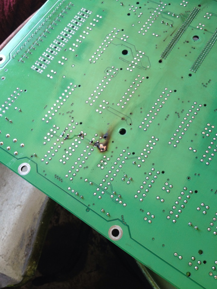

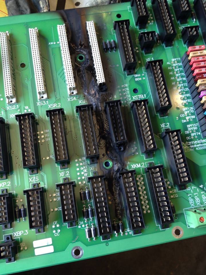

Fry a mother board while full of concrete?
| Todd | 05-11-2014 | comment profile send pm notify |
Blown while full of concrete |
| Farmboy72 | 05-11-2014 | reply profile send pm notify |
What shorted it out? |
| Todd | 05-11-2014 | reply profile send pm notify |
chaffed wire in the turret caused a short,FYI Al,if it happens again,unplug the wire behind the gearbox where the driveshaft goes in,you can fold/unfold the boom by hand,then just use the palm valves to pump the hopper down and suck the ball back,then wash out
