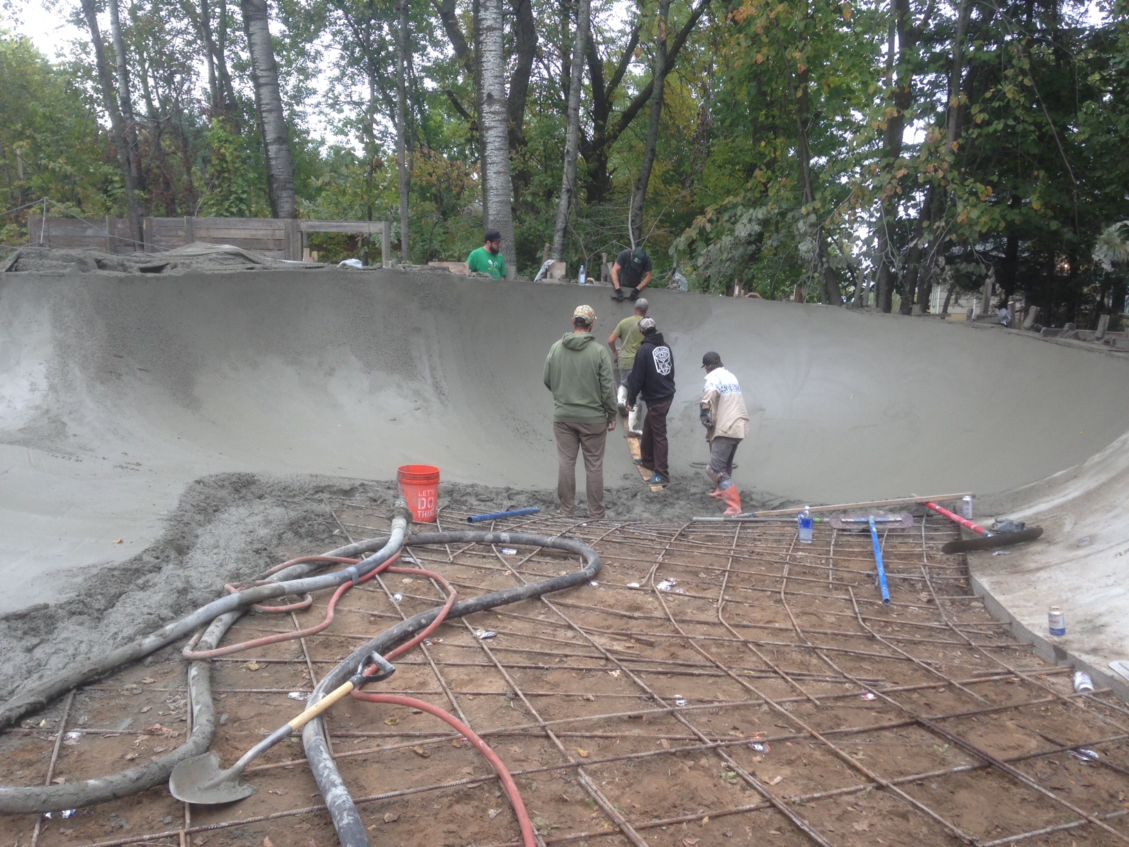

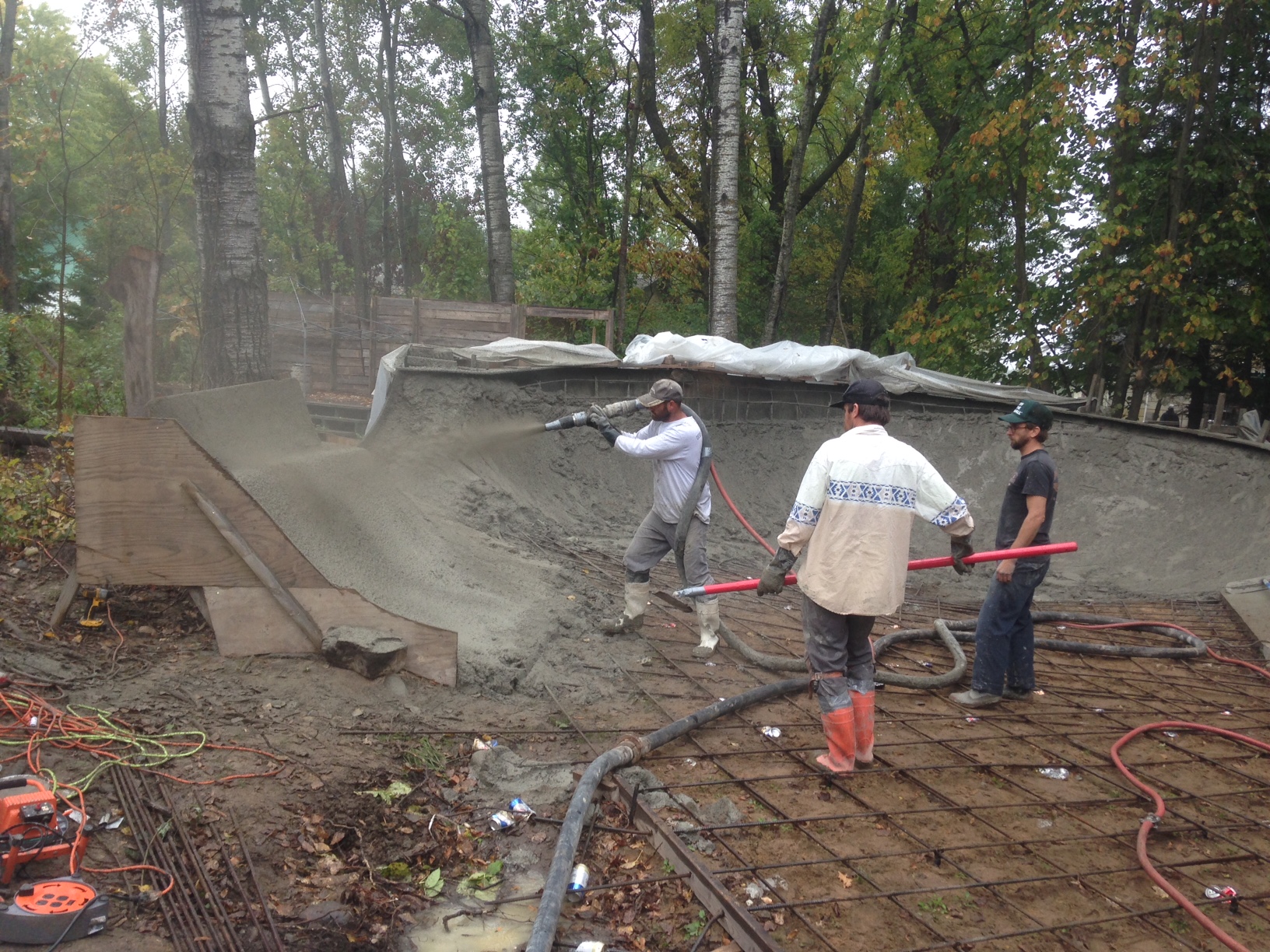

My REED B-50 preformed outstanding. 6hr hours of pumping and she just purred.. I like seeing different aspects of concrete work come together. This guy (the owner) brought a shot creter over from California and about 10 Skater guys from Minneapolis to build the park at his cabin in a small town up here, party spot! Good idea; spend money on what makes you happy! |

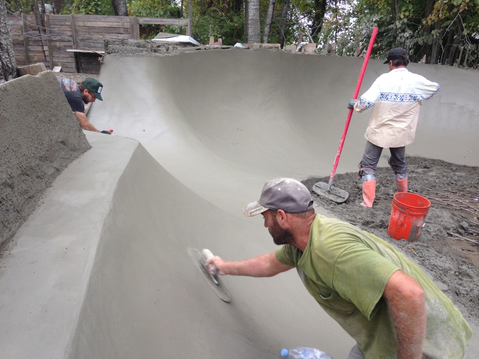

Couple more photos. |

nozzle guy was standing back aways. was there lots of air at that moment. what kind of slump where you running a four. |
b-alto | 09-25-2016 | reply profile send pm notify |
Well, first off the compressor they rented didn't run .. and back up was 1.5 hours away. so i improvised my wheelbarrow honda compressor hooked in tanem with another from a neighbor and we shot the first 1.5 trucks at low pressure (which i was used to). Then the rental place showed up with a replacement compressor and he used great pressure ,wow.. I never shot that high but i'm just the pumper. It worked very well and i learned much. What higher air pressure does flatten the surface and bond even the cold joints. However the higher air pressure made me nervous. |
