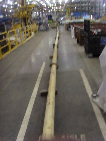

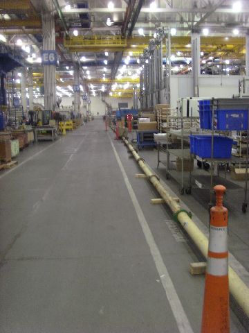

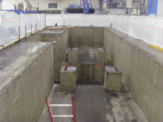

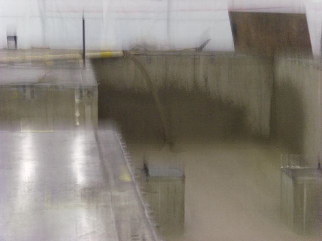

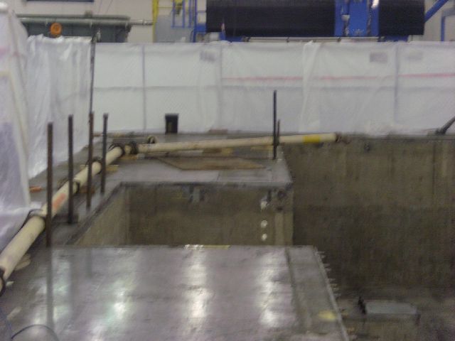

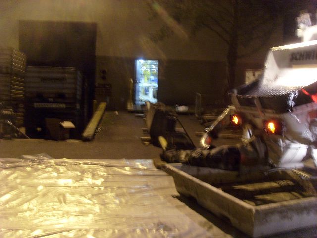

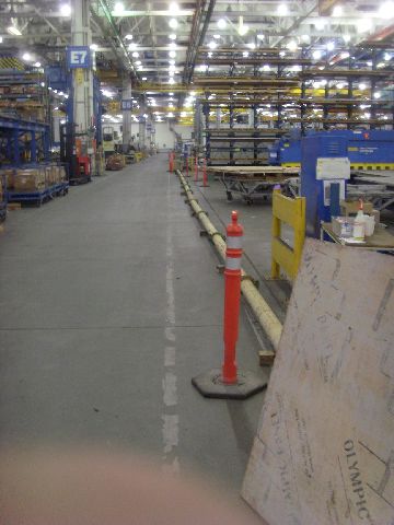

sorry for the blurry pics, took them in a hurry as i wasn't allowed to have a camera onsite ;)
700' of system, filling a block 20'x70'x16' , 639 yards in five hours flat, pouring CDF that was almost a six sack! 1.5 sacs of cement plus 500 lbs of flyash per yard, basically pumping butter |

b-alto | 02-07-2011 | reply profile send pm notify |
How did you clean all that system out? Air? |
Mr.HighRise | 02-07-2011 | reply profile send pm notify |
timed it just right so we left about three yards left to fill( the amount of material in the line) covered the end with plastic, closed a plug valve, and blew out with air, had a guy chasing it all the way to the end, no mess and i farted harder than the sponge came out;) |

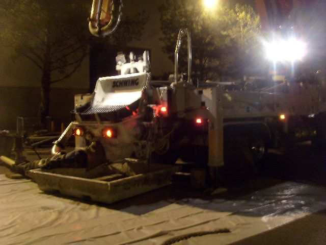

baddassduramax | 02-07-2011 | reply profile send pm notify |
arent the outriggers supposed to be all the way out OR all the way in... |
i can clear a room in a heartbeat, and there is no need to fully extend the outriggers when only pumping off the back end/line pumping |

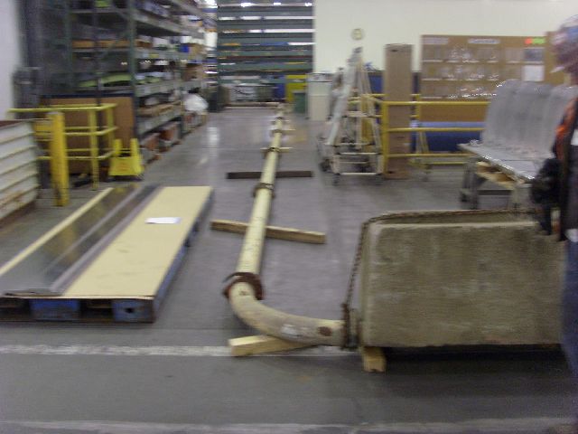

16 CELL | 02-08-2011 | reply profile send pm notify |

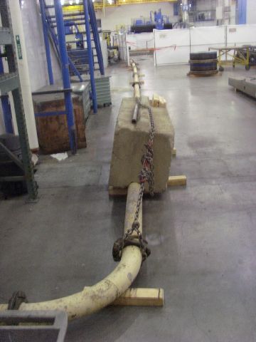

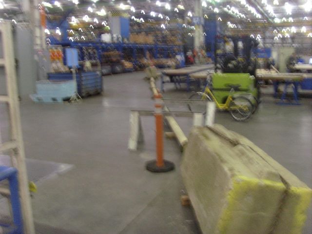

what is the contraption that is attached on top of your first length of pipe? (looks like it has a couple line running to it) it is highly likely that I am just seeing things :) |
baddassduramax | 02-08-2011 | reply profile send pm notify |
seems to me there is a blanket on the swing elbow area and then there is a concrete block on the line probably so it doesnt jerk back and forth like a line does when you pump hard through it. |
