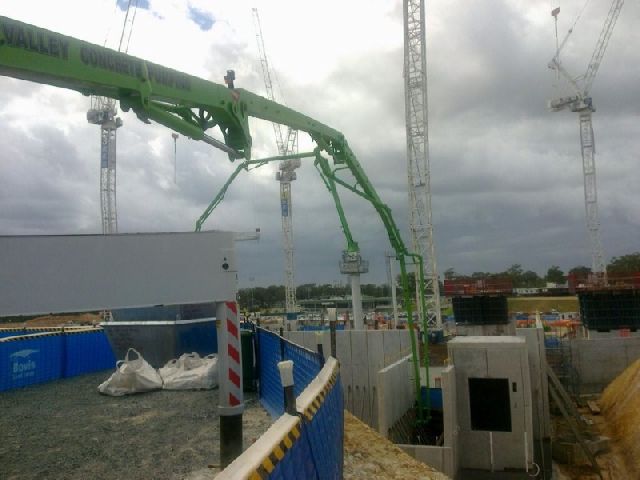

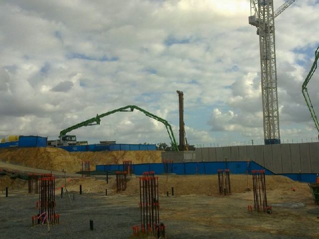

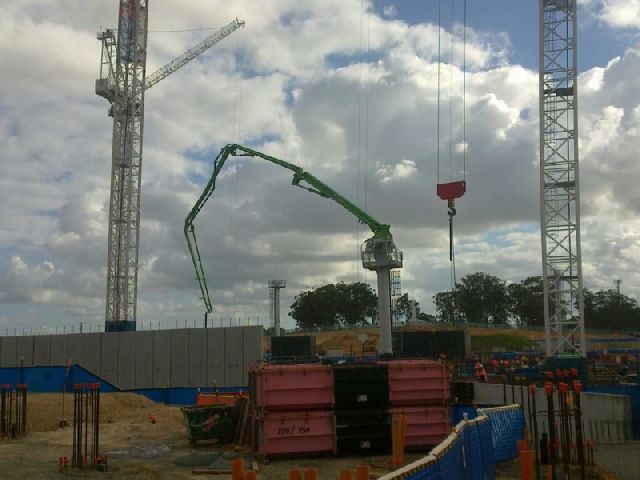

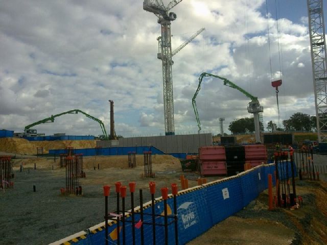

39metre boom into 60metres of ground line then into 39metre tower boom. |

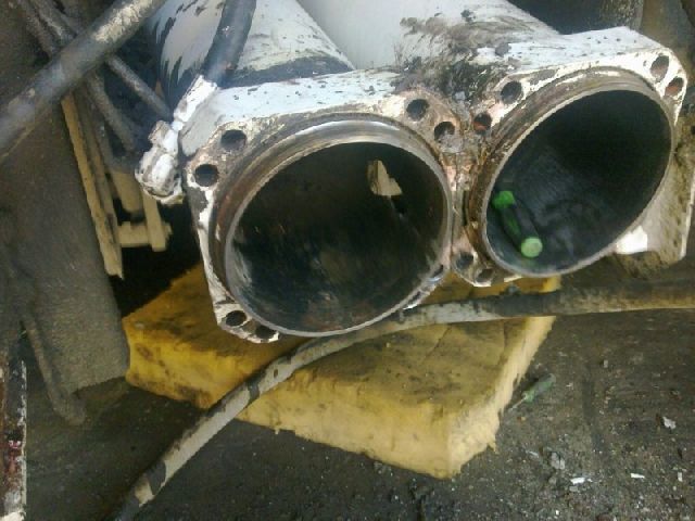

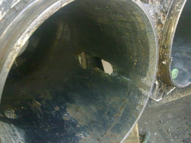

All was going good 180metres in out of 400metres then a crowbar out of the mixer finds its self in my hopper spent the next two days putting new pump cylinders into pump only had 30 000 metres on them still new. |

That's a lot more serious than a fin fish,is the rm company going to reimburse any money? |

rm mix company better pony up for parts at the least. He's still eatin' lost wages while he's down, plus wages for repair time. That sounds like an absentee rm driver. How could you not see a crowbar, or not have time to grab it in the chute. Had to be a big one to punch a hole like that. WOW |
| 2IC | 04-07-2010 | reply profile send pm notify |
looks like it got hit nine hundred times by a jack hammer or was that a rock, who left the breaker bar inside the night before!!!!!!!!!!!!!!!!! |
