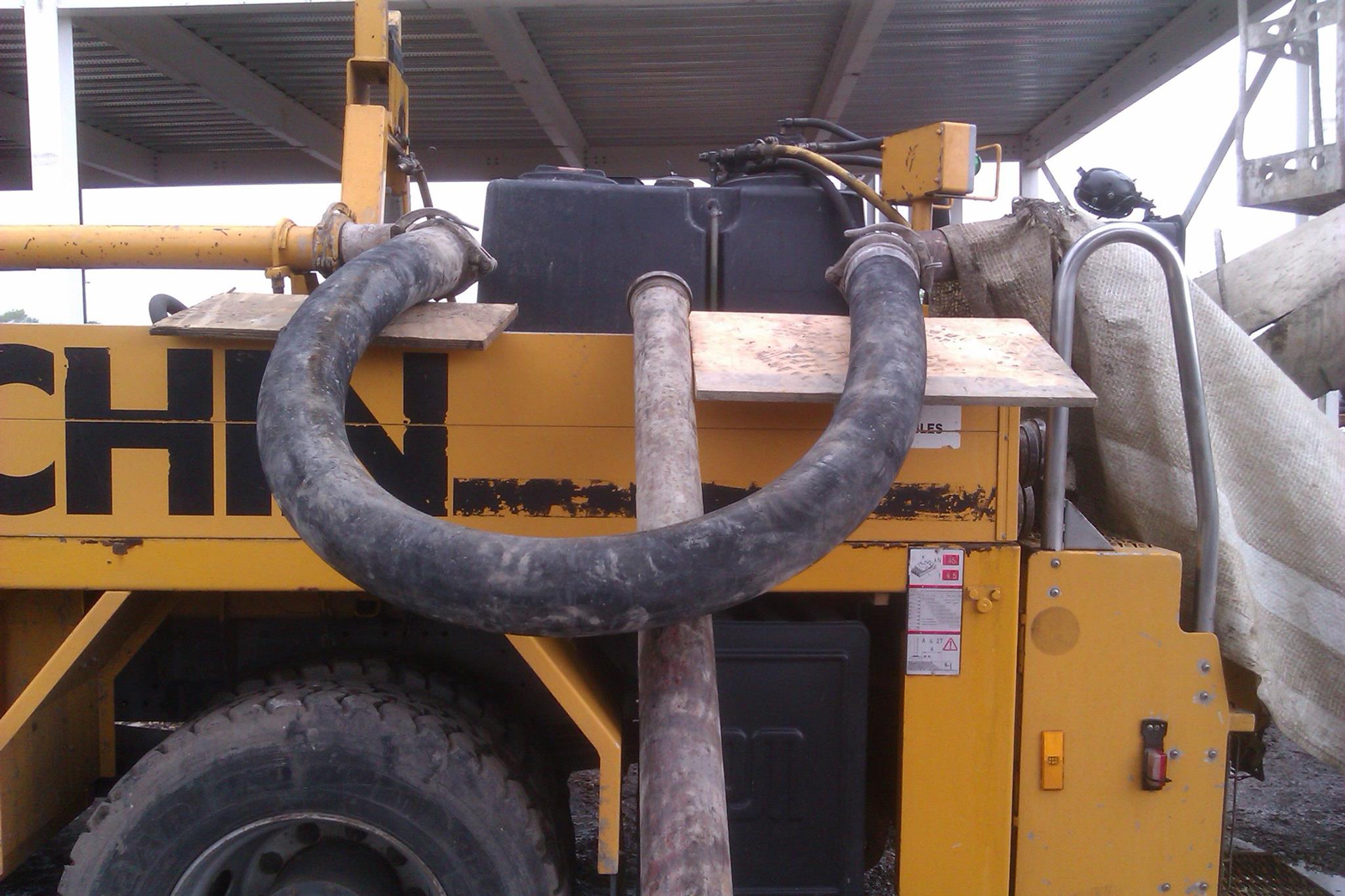

Todd | 09-09-2015 | comment profile send pm notify |
blew the deck pipe at the start of a 200m pour, 2 X 90 bends and flex and off we go. Not ideal but it got the job going until J.B. came with a replacement pipe. |
