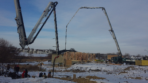

| SunConcreteSmiley | 01-03-2014 | comment profile send pm notify |
Just wondering how many hose everyone else will hang from thier boom? Unlike my competition across the street I think 5 is to many! |
| MVCP | 01-03-2014 | reply profile send pm notify |
I think we all know the correct answer. Weight of clamps,reducers,hose,and concrete cannot exceed maximum set by pump manufacturer. Big liability if and WHEN something breaks. |
| Mister_Perkins | 01-03-2014 | reply profile send pm notify |
im pretty sure all pumps are rated for one 5 inch hose only. |
| yard whore | 01-03-2014 | reply profile send pm notify |
Cant really tell from the pic....but y the hell is he hanging 5 hoses in the first place? |
| SunConcreteSmiley | 01-03-2014 | reply profile send pm notify |
going over house and going through back window to do the floor |
| mudcup | 01-03-2014 | reply profile send pm notify |
I'll only hang 2 12' 4"hose that's it and that's rare |
| dlee7729 | 01-04-2014 | reply profile send pm notify |
If he has a ACPA cert. It should be revoced. |
| jack tine | 01-12-2014 | reply profile send pm notify |
I've hung 40 plus a ten and hung it to clean out and the truck was fine outriggers didn't leave the ground |
