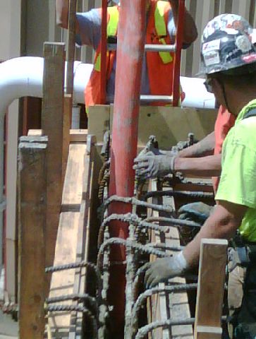

Here is the info on the new hose I was telling you about. I feel that besides the obvious usefulness of this kind of design for tight access walls etc. , the safety advantages are even more significant. The hose can replace the use of pipe and even standard placement hose in many cases. The working and bursting pressure of the Mudsnake at 1250psi /2500psi substantially exceeds that of 666psi / 2000 on a standard discharge hose and 800psi/2400 on wire braided hose. T he weight factor, when considering common accident s in the form of hose whippings back injuries etc. , should have a positive impact on our industry as a whole as well. The comparisons of the weight of  the 4 inch Mudsnake compared to other commonly used 4 inch hoses are as follows . Mudsnake 1.28lbs/ft . Fabric discharge hose 3.3lbs/foot. Wire braid hose 5.4lbs/ft. Nine gauge pipe 6. 8lbs/ft. The selling price is expected to be competitive ranging somewhere between a fabric and wire braided hose. Thanks in advance for your help in getting this information out through the most dynamic media in our industry ConcretePumping.com

Naahh,been around way to long to miss the point.First the picture illistrates a beem in a cast in place deck,yeah right.Most GC's I have been around want production.Now enter "Ricky Racer" god's gift to the pumping industry.He now takes that simple piece of operator friendly equipment and shazaam.
Show me one operator that will use it correctly and I will show you 100 that won't.Let's face it,there are more lazy people out there than do gooders.That was my point,nothing more or less.

Secret Squirrell 06-05-2009
30' wall 4" non consistent opening in mat they tried 3" steel pipe but could not get past 5' from top. Mud snake got down 26' of 30' ill try to get video.
