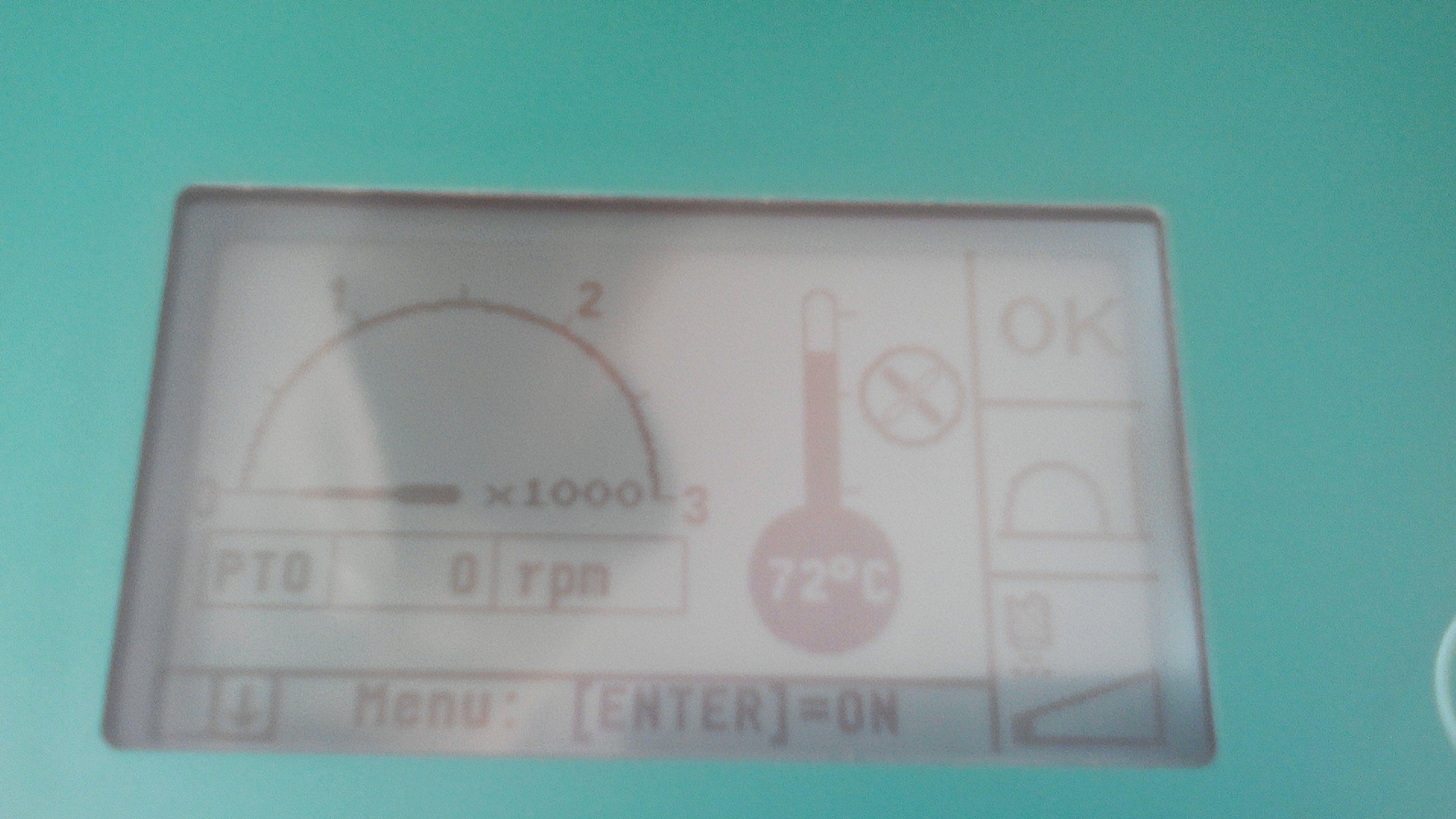

The differential (twin) cylinder in the schwing pump I operate moves very slowly wen pumping concrete even at very high r.p.m & high engine speed, the twin cylinder pumps with a slow stressed motion then after about one hour of pumping the twin cylinders motion will hang by itself and when I engage pumping to forward concrete it will struggle to move on slowly with high stress .....Also the pumping engine sound is not smooth.... Pls wat could be the cause of this malfunction and how can it be rectified.
