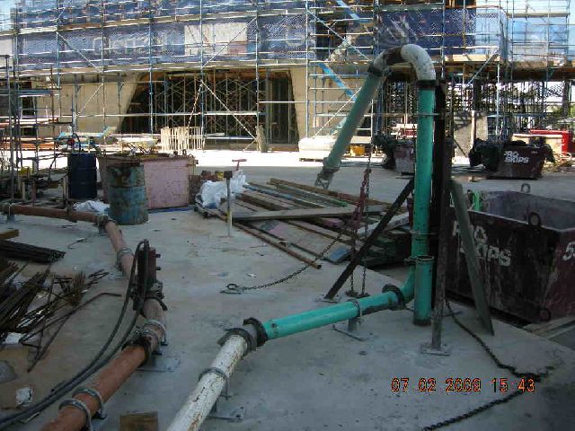

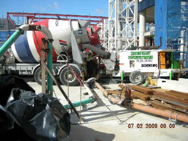

Hey pumpcon how does that blowout system work , do you blow into a bin?? Maybe its the angle of the shot , it looks like its supposed to go into a mixer? Nice pics!! |
| PUMPCON | 04-05-2009 | reply profile send pm notify |
cemex wouldnt let us blown back in the mixers on this site so we started blowing into a kibbel for the precast panels then into bins what a pain in the ass.
| TooTall | 04-06-2009 | reply profile send pm notify |
Cool blow down system pumpcon! Lets see some top side pix? |

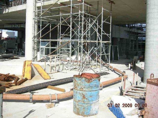

TT ill try and get upstairs and get some pics we have a dvm32 schwing on oct mast up to level 18 only 3 to go. |
| Nebuchadnezzar | 04-06-2009 | reply profile send pm notify |
Does the DVM have the counterweights too?
| PUMPCON | 04-06-2009 | reply profile send pm notify |
yeh got the counter weight a real pain when climbing always hangs over one side so we put a 4th floor frame in makes it a lot easier |
| Nebuchadnezzar | 04-07-2009 | reply profile send pm notify |
So is it on a self jacker? Found that if you have the boom at 45 degrees it stays somewhat centered. Course it all depends on if the carpenters can get the blockouts in the same place. |
