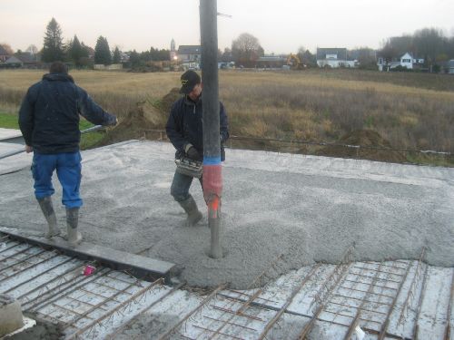

You wrote to me " This looks like a hill-billy rough neck hose no doubt constructed with hill-billy chrome(ductape!) "
I've got a collegue that bought an original rough neck hose. Second day he was using it, he got a plug, the pressure raised and the hose exploded...
Lukily nobody was near the hose but what would happen if you were guiding the hose?
I've never had this problem with my hill-billy rough neck.
Do you or anyone else has got any experience with the rough neck?

I like your hillbilly fix........ on a one ended anti whip hose. Configured correctly; even if it plugs and detaches the hose will not whip.
The double ended hose version is a bad plan.
Kris Leers 11-24-2008
Bob,
I've got already a solution in my head where no metall at all is involved. Will work it out as soon as I got the time and post some pics.
I agree totally with your point of view on double ended hoses. We can't be carefull enough!
On the other hand, if the German association for safety has aproved the Pin Pour system from Putz, they must have tested it very well because I know those Germans are very strict on safety rules.
Even a single ended hose is still steel wire covered with rubber...
If the single ended hose gets blocked and the pressure releases with a power of 10 Ton, the impact will be very destructive as well.
Anyway, the safer the better. I will work on it till I find a solution that meets the requirements.
