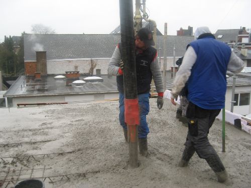

Do it like the pro's, no metall on your discharge hose. |

There you go baby! Hey look, hose-man with no remote box! ha,ha. After your last post (the one with all the big red writing) I thought you might have been angry. Its OK I get very angry also! I have shot (2) computer monitors since I joined! HA,HA,HAA Glad to see you're improving your device. You can call it the "Flow-Cone"? Pump-On Kris!!! |

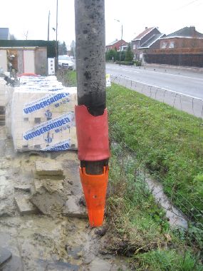

Customers think it's great. I use it all the time. It is indeed a 5" hose. Before we always used a 4" but you often get plugs in the reducer, especially since a lot of plants started with recycled concrete. They crush old concrete and use it in the production. If a long small piece of concrete passes the grid it will probably make it to the reducer and then block up the line. If the pressure raises and the plug releases you've got the equivalent of a canon ball coming out of the hose. Many accidents happened because of this among which a collegue of mine loosing his life 5 years ago. To find a safer solution I started working with the 5" hose. The problem is the splatter when pumping at low speed. Therefore I came up with the cone. It gives a continuous flow and no splatter even if you pump at low speed. If there is a bigger stone, the cone will open and the stone will pass. |

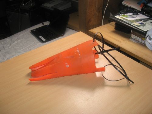

The problem is of course how to prevent the downward force pushing off the cone with no metall connection. After the first post on this topic you pointed out not to use metall for safety reasons and that was also my concern so I started searching for alternatives. For now I just use plastic straps, the ones electricians use to bundle cables. A few around the hose and three going down works fine to me. Make sure you make slits in the side of the cone: in case the pressure raises the cone opens instead of coming down. If you start pumping, don't pump to fast untill the first concrete has come out. And in case of a block up it's better for the cone to come down then having the hose flying around under maximum pressure in case the plug releases. If you try it out, I suggest not do it on a wall till you got the trick so in case the cone comes of you won't lose it. I've got something with a velcro strap but it still needs some improvement. I'll post pictures as soon as possible. |

Here's a picture of how I put the cone on the hose at the moment: just a few plastic straps. It works fine but I'm working on something with a velcro strap to put it off and on more easy. I'll post the pictures as soon as possible. |
