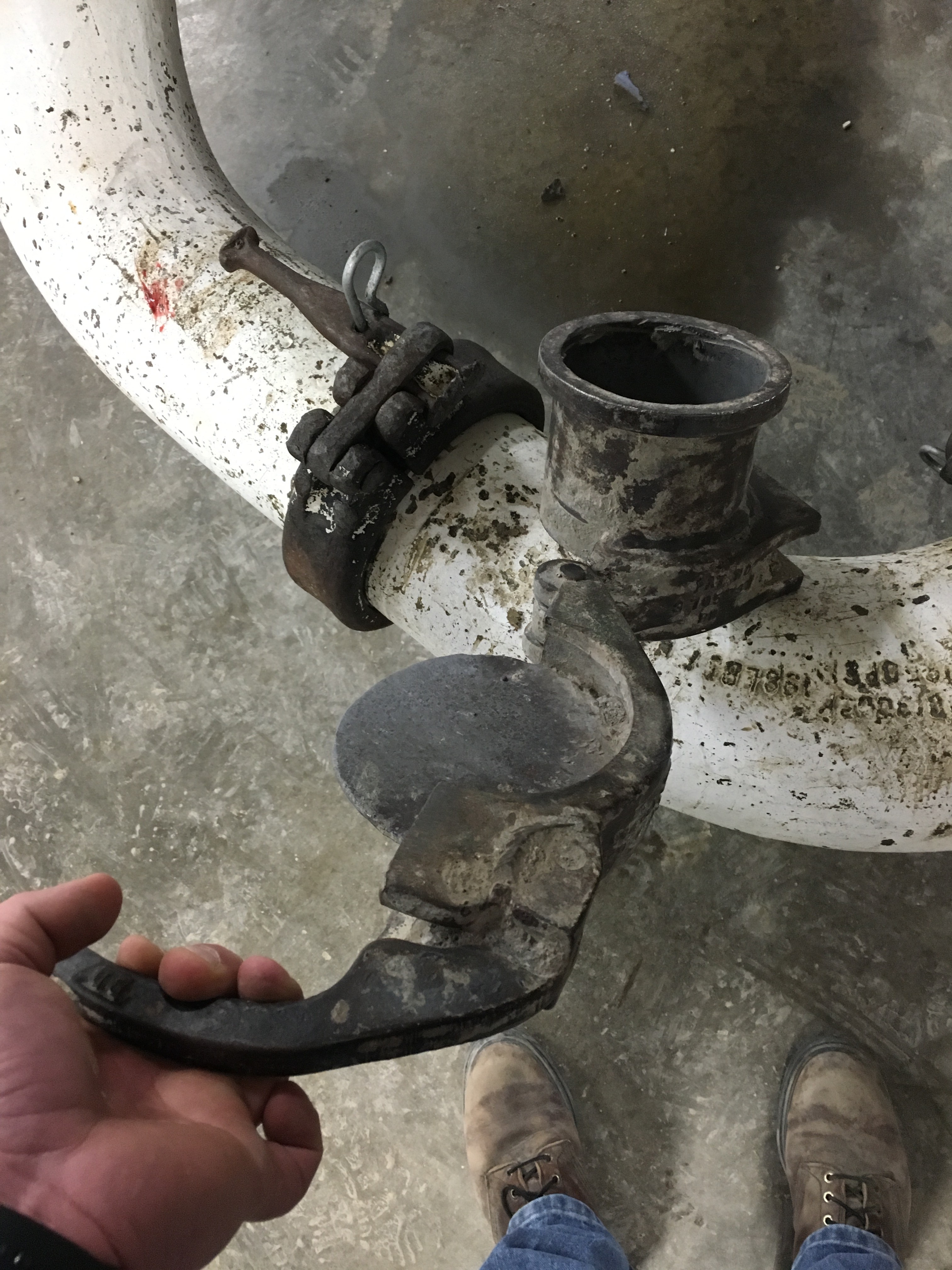

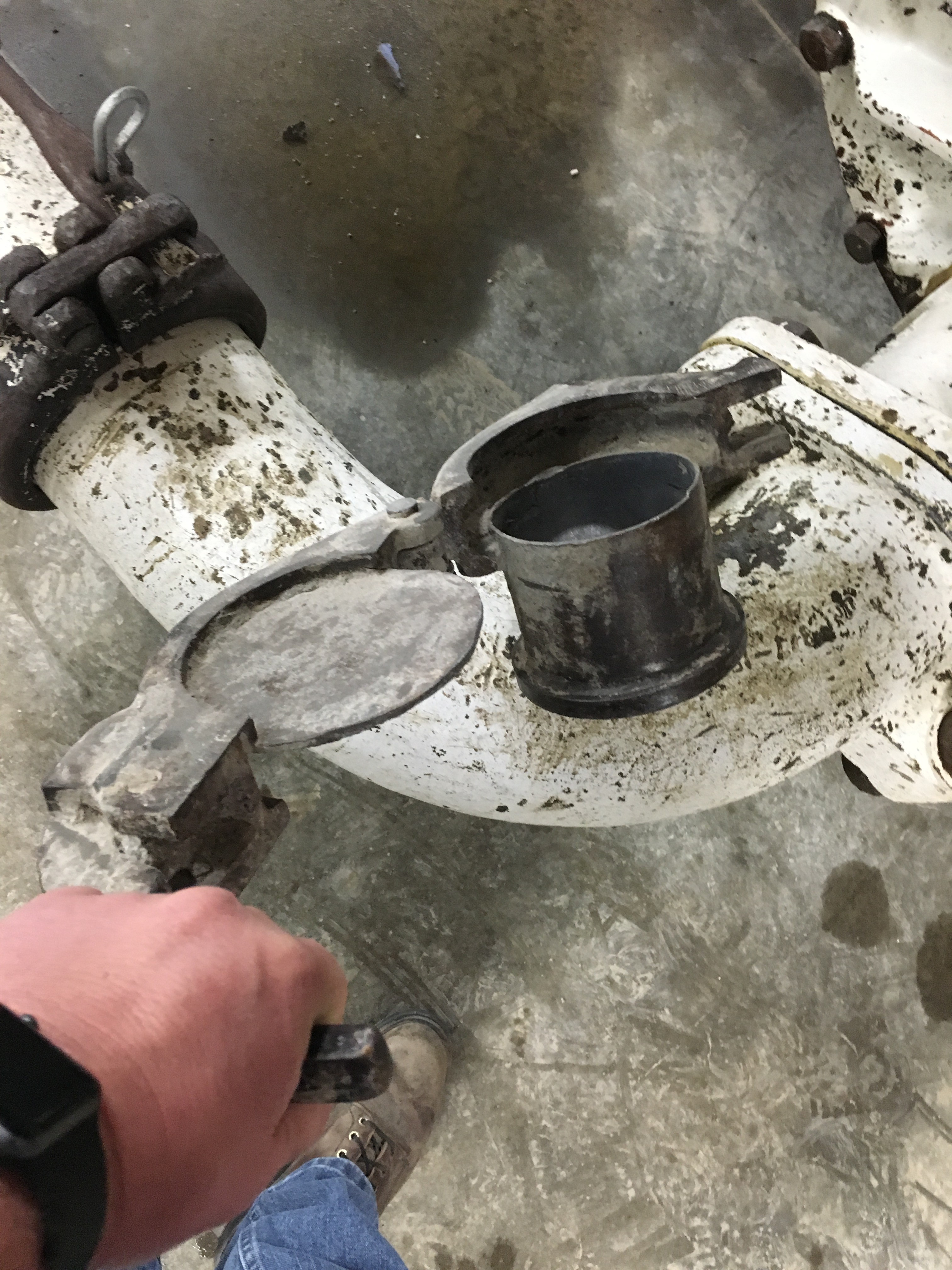

ahssci 03-11-2016
This is what some of the guys use. Just an old clamp and a tip pf 4" line welded together.
Dipstick 03-11-2016
Yes.. Apart from the fact you need a double ended hose to use that...
Farmboy72 03-11-2016
