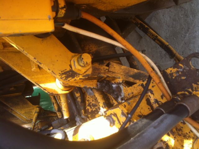

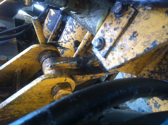

what is the reason for these cracks?and what is the best way to repair it? |

call the company that built the pump and ask for a procedure to repair the cracks |
Travelteck | 03-10-2013 | reply profile send pm notify |
Gillrod has the corect responce for the repair. If you want and If it is a Putzmeister you can send me the Pump Serial # and the pics on E-Mail to woodsa@putzam.com I will forward the info to the Eng Dept for repair procedure. One of the reasons is age and shock, I have quite a few issues with these especially when the operator has to travel "wet" with concrete in the hopper, the rough roads and extra load in the hopper when driving can help these kind of damages. Remind the operator to slow down and to transport full hopper as little as posiable, long distance with a loaded hopper will add extra wear to the mount parts. We cant always clean oout on site, so being aware of the extra weight in the hopper and driving with that fact in mind will help to lessen the damage |

it is sound very reasonable thanks for help i will send email to you |

I have sent the info on to PMA You should be contacted directly, please contact us if you dont get a responce back.
shady rashed | 03-13-2013 | reply profile send pm notify |
thanks travelteck they already contact me and they asked me for more pic to check from where the crack is started and i sent to them today |
