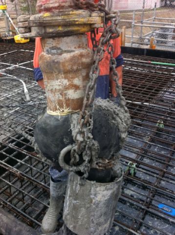

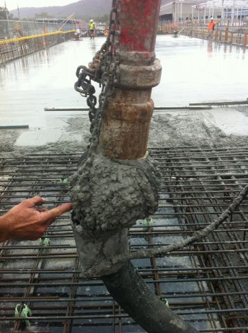

jonno | 01-17-2014 | reply profile send pm notify |
I find when you pick the hose up and it bends (kinks) real easy or has soft spots, it is probably time to replace!! and like PUMBO said if you can see steel belts THROW IT. |
Mister_Perkins | 01-17-2014 | reply profile send pm notify |
you forgot to Release the air cuff didnt you ;) lol jk |
