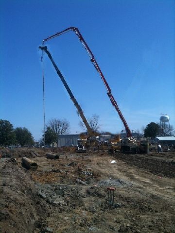

This is a job I got a call on. There is a different pump company doing it now and they want to change. There are 160 piers, 18 and 24 inch. The piers are 40 to 65 feet deep. This company had no problem hanging all this pipe from the boom. It is 4 inch and not very old, so its heavy (5, 4 inch pipes + clamps + 4 foot 5" to 4" reducer + 5" tip hose) . They are welding together 6, 5 inch pipes to hang for the deeper holes.
There is a crane on site but they are using it to pull the cases and won't hook to the pipes.
I need the work as much as the next guy but told them I wouldn't hang that much pipe.
Would like to hear some opinions on this.... |

I have always been in the opinion hanging 5" is better than 4" as long as you turn the volume down as to keep the concrete falling not filling the 5" up with concrete, but that is way to much pipe to be holding , a crane or some thing should be used to assist you , your pump probably would hold it , but you could experience problems down the road our booms just arent engineered for this, I think they have a pic of a nub on this site they use as a tip section that would work well for you. |

I love it when operators do this, it generates a lot of revenue for me !! Has any body seen what a tip section looks like when it opens up ? Some of them are only 3mm thick , and most pump manuals have a stated weight limit or the very least a sticker with the weight limit on them some where on the boom. You guys/women are not operating cranes , the only proper set up for this kind of work is what Northwest just posted with a manufacturing engineers stamp of approval.If you do this on your own accord, then you and your company will take %100 of the responsibility in a court of law if this boom failed and hurt someone. We all realize it is your pump to do with as you please, But would you sleep well at night if you injured someone in the process of doing a not so safe set up as this ? Any one hanging this kind of set up from there concrete boom will eventually have a boom failure, for that I am sure. If not on that job then later since the metal is fatigued from all the pipe weight ,Its just a matter of time. And one piece of friendly advice,never take a picture of your pump doing this then post it online, this is what lawyers dream about. |

Yea Secret Squirrell, I know that northwest set up originated from the manufacture, I was referencing the first picture on this thread. |

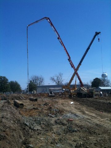

txredman you have a few options rather than not doing the job. #1 would be to hang the same steel pipe but have that crane swing over and assist by holding the pipe and keeping the weight off the boom. Like so... |

Just my opion . The operators manual states what can be saftley hung off the boom. Anything longer should be supported by a crane . Bottom line go by your operators manual or call the manufactor if you have questions. |
| milkman58 | 03-09-2010 | reply profile send pm notify |
ANYTHING OVER 30 FT. CRANE ASST.OR TELL EM NO WAY,SAVE YOURSELF A BENT TIP.... AND OR A LAWSUIT. AND DON'T USE A PVC THATS JUST A ACCIDENT WAITING TO HAPPEN......... |
