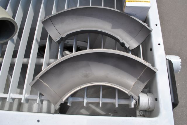

I agree with Vasa and gavros! The price is not that much! But also I realized now that not all the pipes have "filler" inside. On the picture attached you can see 2 kind of bends: one has some filler between the steel layers, and the second one has not. Suppose that we can say that all the straight pipes have an air gap between the layers of inner Hard steel and outer layer. Usually the bends have this gap, but in some cases - not: the gap is filled in factory with some polymer or it is naturally filled by concrete, coming into the gap through the special holes during the first pour. Speaking about an ultrasonic method, it is true that even a thin air gap between layers is a critical barrier that cannot be overcomed by ultrasonic waves... That is the limitation for this method. Looks like it is not possible yet to cancel the operator`s duty to take care about the wear state of concrete delivery pipelines! |

Yuri As the former Esser Sales guy here in the US I wanted to let you know that the pipes are not at all like the elbows. The elbows with the "filler" material are the 900 series and that material is there to help absorb some of the impact and shock from falling concrete when the pipeline system is angled all goofy. The pipes have no gaps between the inner and outer walls. That doesn't matter if you are buying Esser or CF twin wall pipes or anyone else for that matter. Lastly there is no ultra-sonic tester that is capable of giving an accurate reading on twin wall pipes without a special tip on the reader. The best thing to use in the case of measuring the pipes and elbows is a caliper that allows you to reach inside the pipe and for you to take the measurement of the total wall thickness. If you have any questions feel free to send me a message and I will do what I can to help you. Best regards Will |
