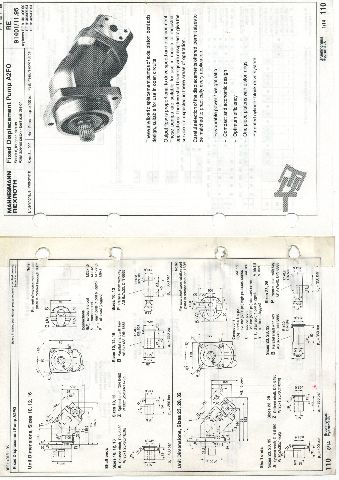

   Looking for 2 Hyd. Pumps for my 1985 schwing (the ones for boom-aggitator.) or rotating assemblys to rebuild.  Schwing doesnt have in stock and so far hasnt told be how long it would be to get..
   Local hyd shop has them torn down and looking for parts to rebuild so far they haven't found what we need dont know for sure how hard they're looking.
1)- A2F.10.L.4.Z.4    1)- A2F.23.R.3.Z.4            Any help will be appreciated.    CRAIG

Brevini, Sauer Danfoss Dakin and Volvo have banana pumps that will inter change with Rexroth A2F models.
DIGGER 10-28-2011
The main items you need to know will be the shaft size, on the A2F10 it's a Din 5480 20 mm x 1.25 x 30 x14x9g
The A2F 23 is a Din 5480 25 mm x 1.25 x 30 x 18 x9g spline.
The mounting flange and the shaft once matched, the alternatives will fit. Suction and pressure ports can always be modified.
We use a lot of "will fit" Brevini pumps on Schwing, Putz and Korean models.
