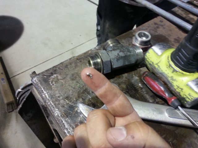

I totally agree with you. I figured this would be a more discussed topic. I always say it is better to be proactive than reactive. i really had an eye opening discussion with our cat dealer a few years ago, they told me that when they get a fresh load of bulk oil, they take a oil sample before they let the truck unload it, and several times they have rejected the load of oil because of the levels of garbage in the new oil! even after they accept a load of oil they filter it just as you do. The second thing i learned is the dirtiest oil you can buy is in the 55 gallon drum. Especially if they are core charged drums, they never get cleaned before they are refilled and sold. if you ever had a chance to drain the main reservoir on your pump and see what lies on the bottom of your tank you would have nightmares. its really surprising how much stuff settles out. another thing i have noticed is to always check a rebuilt cylinder when you get it back from the hyd shop. sometimes they are in a rush and dont take the time to clean the grenaded pieces out of the assembly while they rebuild it. heres an example. |
