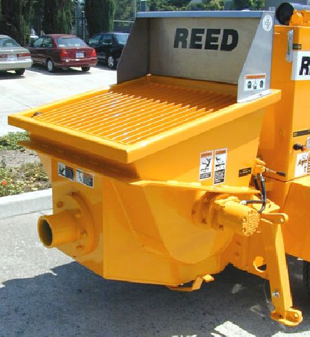

My Reed B70 pump sprung a leak the other day while pumping on the job. Had to quit and pack up and go clean out. Wasnt sure what happens when you run out of hydraulic oil.
does it wreck the pump? or does it just stop pumping and just idle? I had a 20 min drive back to our yard before i could wash and had the pump running in idle the whole way home. I also checked the level before i left and figure by how much was in there and how fast it was leaking i could make it back.
anyway its all fixed now, but i was wondering what happens.
