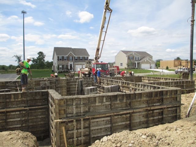

I was hired to operate A 2004 Schwing KVM32XL on A Mack truck. 4 weeks into employment now an I have pumped 3/4 of 1 basement, All 8 foot walls. Boss man very busy an I need help to learn how to run it. Ben on the yard drawing straight lines with it for about 10 hours. Boss said I done A good job when I pumped some of the job. How do I learn how to run this? All I have is A short instructions book an what little time he can give me. Have grown up in the trucking industry an still own one today. Not stupid, Just educated enough to ask for help. |
