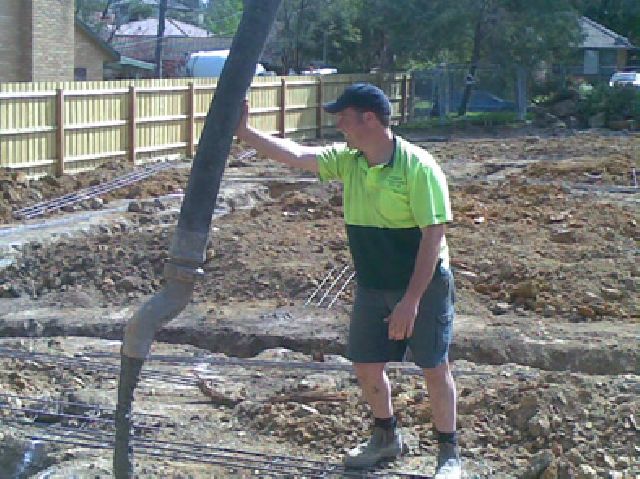

I mean what is up guys? Is this how you guys roll down under? and than post it on your web page? Tell me its not so. http://www.concretepumping.com.au/contact_us.htm |

Man that would put a damper in his day if he got smacked with that thing. |

I think we have all done things that are wrong, even crazy. In fact i have some stories i could tell you but I would not put them on the front page of my web page so everyone can see how much of a dork I really am. |

no todd this is not how we roll down under. |
Mr wibau | 01-09-2010 | reply profile send pm notify |
come on todd you have seen our pxts latly, we dont do that shit, but as photos of guys doing that over there always pop up you end up with the same here. i guess we cant help every idiot. |
Boom Inspector | 01-09-2010 | reply profile send pm notify |
well atleast the guy looks happy in this picture LOL "ignorance is bliss" and this guy is as happy as a 9 year old with his first puppy.. HaHa |
northern pumper | 01-09-2010 | reply profile send pm notify |
I am having a hard time understanding some of you people on here. Has it truthfully been proven that having a metal end on the end of your hose or a elbow of some sort is that dangerous when a hose whips of is it just the hose whipping that causes the damage? Lots of my customers like having a device on the end and how the hell can you cap a hose with no end when you have to boom over something and don't want to drop concrete on something cause as we all know it doesn't matter how long you let a hose drain it will spit concrete at the wrong time! |

N.Pumper 15years ago when I worked out of Vancouver we heard of a guy over in Kelowna getting his face shattered from a double 90 when it plugged and released. I tried for a couple of years after to get documentation, no luck. The danger is real. JUST THINK of getting whacked by 40lbs of steel at 300bar. I have had the misfortune of being struck by a whip hose whith out any steal on the end, and i got laid out. BACK 15 Years ago WCB. had discussed banning these devices and as ussual in our industry as long as nobody has to charged or sued due to seriose injury or death. Nothing gets done. In our industry we have to know more than crane operators yet we are treated like everyday labourers. This is also the very reason our industry is in such bad shape. It needs to be more regulated and saty has got to be enforced. THAT IS MY VENT FOR THE DAY. BE SAFE AND KEEP THE TIRE SIDE DOWN AND YOUR BOOM OFF THE GROUND. |

Northern, Have you ever had a hose whip? I use a snowmobile drive belt and kink when I don't want a mess. I whipped last summer and put a friend of mine on the ground, a really scary moment and he would have been in the hospital if there would have been metal on the end of that hose. {He has never ran that hose again!} It is a very powerful dangerous thing when it happens//// |

i love the "have you seen proof?" argument. dude just because you haven't seen it happen doesn't mean it hasn't happened. let me tell you something, if you kill someone with one of those things, not only do you have to live with the guilt, but you might also do time. at the risk of loss life and freedom over a lost customer, i'll take the lost customer. |

How do you cap off a hose w/ no end on it??? Are you kidding? Seriously whether your running a 3'', 4'', or 5" hose you can kink them all off with a little thing called a "HALO" You know like the angels where. I myself have used steel tie wire just like the iron workers use for most of my days and it works well. It's readly availabele,cheap and only takes a few min to make. |

A least hes not getting any splatter on him haha, Could you imagine that recking ball, ouwch. |

Dangerous, illegal, but then again having any reduction (5" to 4") on the tip in the air is not supported in any manufacturers operating manual. Thats a big safety hazard, even with safety chain. |

Hell i have seen a hose man taken off a job in an ambulance bleeding just from a whip of a hose without any steel on it thats proof enough use your head and at least try to make are industry a little safer |

Good point In the past 30 some years I have seen hoses (tip or line) do some of the darndest things.Forsure there's no rhime or reason,just the luck of the draw.In the old days these pumps didn't develop the quick pressure build up.Todays pumps build so fast even the keen ear can't stop the inevitable.Do as one wishes,not me. Just the facts |

You know the first thing I noticed? No hard hat, safety vest or long pants. Saw the "Life Eliminator" next. |

Here's my question. Has anyone that kinks their hose notice that they prematurely wear out their hose or even blow the hose in that spot they kink it at? Sorry but the explosive pressure of a hose blowing in ones face is a safer situation than having a steel end? I'm not saying a steel end or double 90's are the answer they're also dangerous but perhaps ther is a million dollar idea out there that doesn't require a steel end to cap or kinking a $800 hose. Anyone who says the hoses won't weaken wwhere you kink either does not pay attention to their system or doesn't buy the system. And speaking of safety what is with these 20 ft hoses I keep seeing in pictures. Not only overloading the boom but wow f@#$ing weeeee what aride if that thing cuts loose from an air lock or a plug steel end or not. So yes I agree about steel ends being dangerous but once again this industry is always being reactive instead of proactive. Myself I use a ball suck back 2 or 3 strokes swing to where I need to be pump the ball out. Yes it can plug to although it only seems to happen if I wait around to long before starting to pump, Winter time soak ball in anti- freeze and it won't freeze in either. |

There are things called "air cuffs" spend the xtra cash and get one or use the "halo" method when moving the hose or the ball method mentioned above . And yes kinking your hose is not a grand idea as it does tend to weaken it alot over time. And "PJ" it is Todd's and everyone elses business, not just the owner of that website when something is published that is potentially hazardous to this industry or in the very least his employee's. And as an "Industry" we as a whole need to bring bad pumping practices to light, my god how many more of your friends or mine have to get hurt by a silly ass tip hose set up like is shown in that photo or by using steel ended tip hose's before someone or all of us stand up and say we've had enough ??? Its better that we use our best skilled judgements when it comes to this industry , rather than a law mandating the none use of metal on a tip end hose !!! Schwing sent out a notice in 2003 recomending the "no metal on tip hose" I will send Todd the .pdf file , it was written by Rob Edwards also. And he can post it if he wants too. Im just saying that because even the pump manufacture or at the very least Schwing recognizes the safety problem. Pump safe / Pump smart/ come home to your family !!! |
