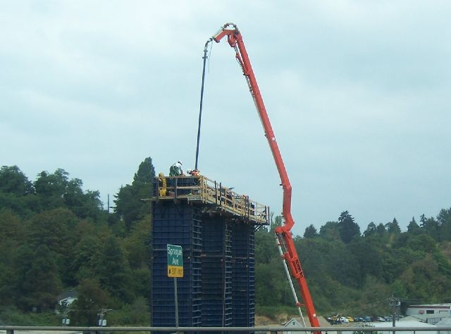

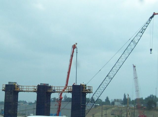

And leave it to B.ig B.rother to do just that! Hope this done get the concrete Mafia breathin down my neck? I snapped a couple shots on a drive by last week, At first I couldn't figure out WTF kinda 3 section boom it was til I got close enough for a couple pix. I can handle BigT and the SecretSquerrell but that fifty cal their buddy's got may be need for concern... Just think, somewhere is some lonely tip section laying on the cold dirty ground... |

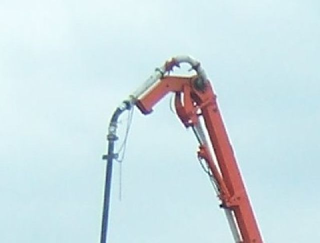

Here's the good one... |

Think this is taking tootalls tip section to a new meaning lol |

TT,any more to this story? Looks kinda different. |
Pump N00b | 08-18-2009 | reply profile send pm notify |
WTF? They took of the tip section? |
BIG PAPA PUMP | 08-18-2009 | reply profile send pm notify |
Between cali and here we've got abot 3 of those. One 47 and 2 39's, they work sweet! They were dessigned just for using a trimee. They work beautifuly on case-ons ect. And don't worry for all you sceptics out there they are engineered to do just that, nuthing more nuthing less. |

well, that just isnt wright. come on someone broke the tip, so now is been cutoff straight, and back in service.. looks more like some kind hybrid crane. |
pudding | 08-18-2009 | reply profile send pm notify |
In todays economy seems very practiacul. Insteed of utilizing that crawler behind it.cutting cost...but then again weres the crain opp. sitting at home.How does the tip attatch to the boom. |

Thanks for the pics thoe they arnt the best you have taken lol. It safe tested and most of all they love it. |
TooTall | 08-18-2009 | reply profile send pm notify |
Hey they're not bad for being taken at fifty mph in a pump! That's the only way to go on caisson tremme jobs, no crane assist and saves everyone time & money! |

Just to let everyone know the pipe IS being asisted by chain on 2 sides as to keep from having a chinese handcuff effect. |

Seems to I remember something about that section.Wasn't it done by putz and is an aftermarket thing for them? |
Secret Squirrell | 08-18-2009 | reply profile send pm notify |
Yes and they have used it for 1 or 2 years then schwing was asked to do the same and here we are. |

These are 80 to 90ft coll's continuas pour contractor opted to not pressure pour due to the height and pressures during a continuase pour so here we are besides a chopper any other ideas on how to get concrete in there? Atleast schwing and putz gave it 3 hailmaries and a dash of holy water? |
Many | 08-18-2009 | reply profile send pm notify |
SS,ya have a point there,good option.How many yards in each one of those bad boys? |
Anywhere from 80 to 170 each. i thought a chopper would be cool but not cost effective lol. |
