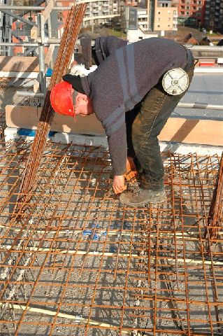

It looks like it is little rebar , was it steelfibre in the mud ? If , how many kg/m3 and how long ?
When do you get problems to pump mud with long steelfibre ? |
| Mr wibau | 03-21-2010 | reply profile send pm notify |
just looks like a stressed slab, which doesnt need steel fibers? |
| SUPERDOFFER | 03-21-2010 | reply profile send pm notify |
vasa i think that we in europe have a diverend point of vieuw about rebar. |
